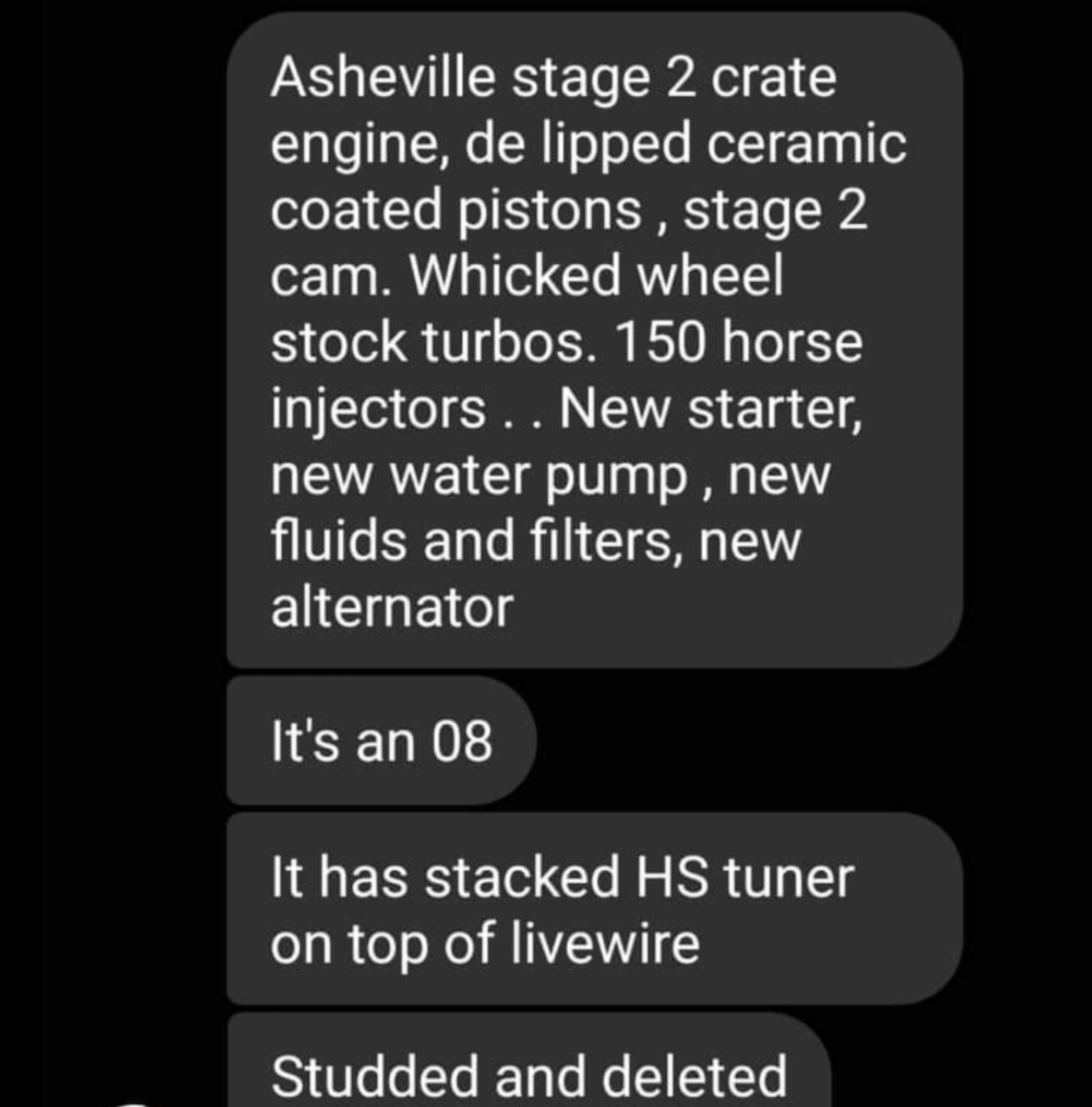

Anyone familiar with these guys? Friend looking at a truck with one in it. Appreciate any info provided.

Not sure on ashville but anyone claiming to have "stacked" tuners on a six four I would stay clear of.

Asheville makes a good engine. Look them up. You can always unstack the tuners, but you'll need tunes for that to run right. A stage 2 is a hot motor.

Asheville definitely has a great engine program. Wouldn't be scared of that at all. Crank walk is not really an issue with these trucks, that's more of a 6.7 thing in high horsepower applications.
The biggest issues are the pistons cracking but if he already has the Asheville setup with the ceramic coated pistons that problem should be resolved. The Rocker Arms are definitely a weak point but pretty cheap to replace with stock or if you wanted to go with something better you'd be looking at 3000-3500 for something like the Harland Sharp Rocker Arms with Pushrods and HD Lifters. There are Solid Lifter options as well but adds another good chunk of change.
Most people just replace with stock ones but I've had a few people do the good stuff on race truck applications and things of that nature.
I would definitely be a little worried about the tuning situation. Anyone that uses that terminology on a 6.4 has no idea what he's talking about. But what that probably means is someone set everything up for him and he's never touched it. Take that for what it's worth..

Thanks a million for all of that. I'll pass it on to my friend. First thing I asked him about when he mentioned it was delipped pistons. Once I saw that and ceramic coating I felt a little but better. That's cool Harland Shop makes rockets. I definitely know that can be an issue for sure. I here you about the tuner thing. Some people just have more money than real knowledge/sense about these things. I guess they here that crap from the Dodge VP44 guys and think it's cool to say stuff like that. Idk.

So it looks like she needs a head gasket. Not sure how a stage two motor lifts a head with stock turbos, but I'm not familiar with this platform. Sounds like some other shenanigans going on. Not sure if these motors come with fire rings. He said something about that, bit he might have just been mentioning it when he goes to replace the head gasket.

Whoever put the engine in it probably did a short block. If that's the case, it probably has stock heads on it and could even have factory bolts in it still so it would make sense for it to lift the head. If it needs a head gasket just tell him to go ahead and get the KDD O-ringed cylinder heads and make sure it's got ARP Studs going back together.
Honestly sounds like this thing will end up being a money pit just like every 6.4 but if he can get it for a good price everything is fixable with the right parts. If it's for sure got the pistons taken care of that's a big deal for sure but I'd be worried about it even having that at this point.
If he does end up getting it I'd be glad to help with any parts that are needed and whatever advice I can help with, my email and contact info is in my signature. :thumbup:

Stacked tuners, wicked wheels, and describing the injectors by hp would be HUGE red flags. Enough that I’d stay away from that 6.4!!! Couple that with it supposedly being studded but needing HG or even new heads, that either means the block is cracked from over tightening on the 2 upper studs with less block material around them, OR it was abused. Most likely both.
I’d stay far away from it unless he’s getting it for next to nothing, then doesn’t mind spending thousands to rebuild it...

I know all of the usual red flags, like the things mentioned. Most likely some pipeliner who doesn't know any better selling the truck. It's a young man that clearing my property that's thinking about buying it. I think he can get it for 6k. I thought the same thing about the head studs and blown gasket with stock turbos. I can find out who built the injectors when I have a chance. Lol

Does he have paperwork with what actually was done to the engine? That would help knowing what you could possible expect to find once the heads are removed.
But you need to make sure the kid under stands that he will, not might, he will spend, 10-15K to get it right.
