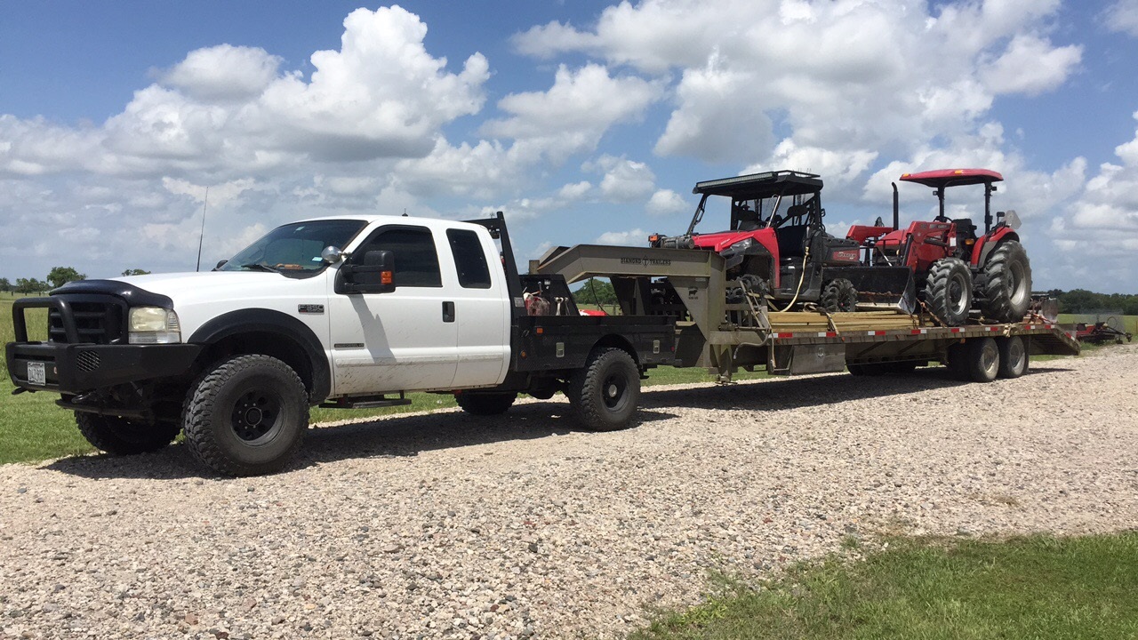

And i wouldnt worry about the truck handling the trailer loaded with a few cattle.. this is my 01 and has been used like this for about 10 years now.![]()
