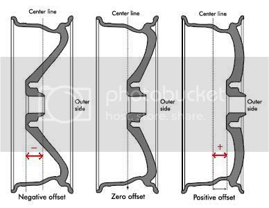

theyre related but not the same.
BS is the distance from the inner lip to the mating face of the wheel.
my 20x10 fuels have -24mm offset and around 4.5" BS and stick out 1-1.5"
20x9 with 0 offset will have the same bs and stick out just 1/2in less
