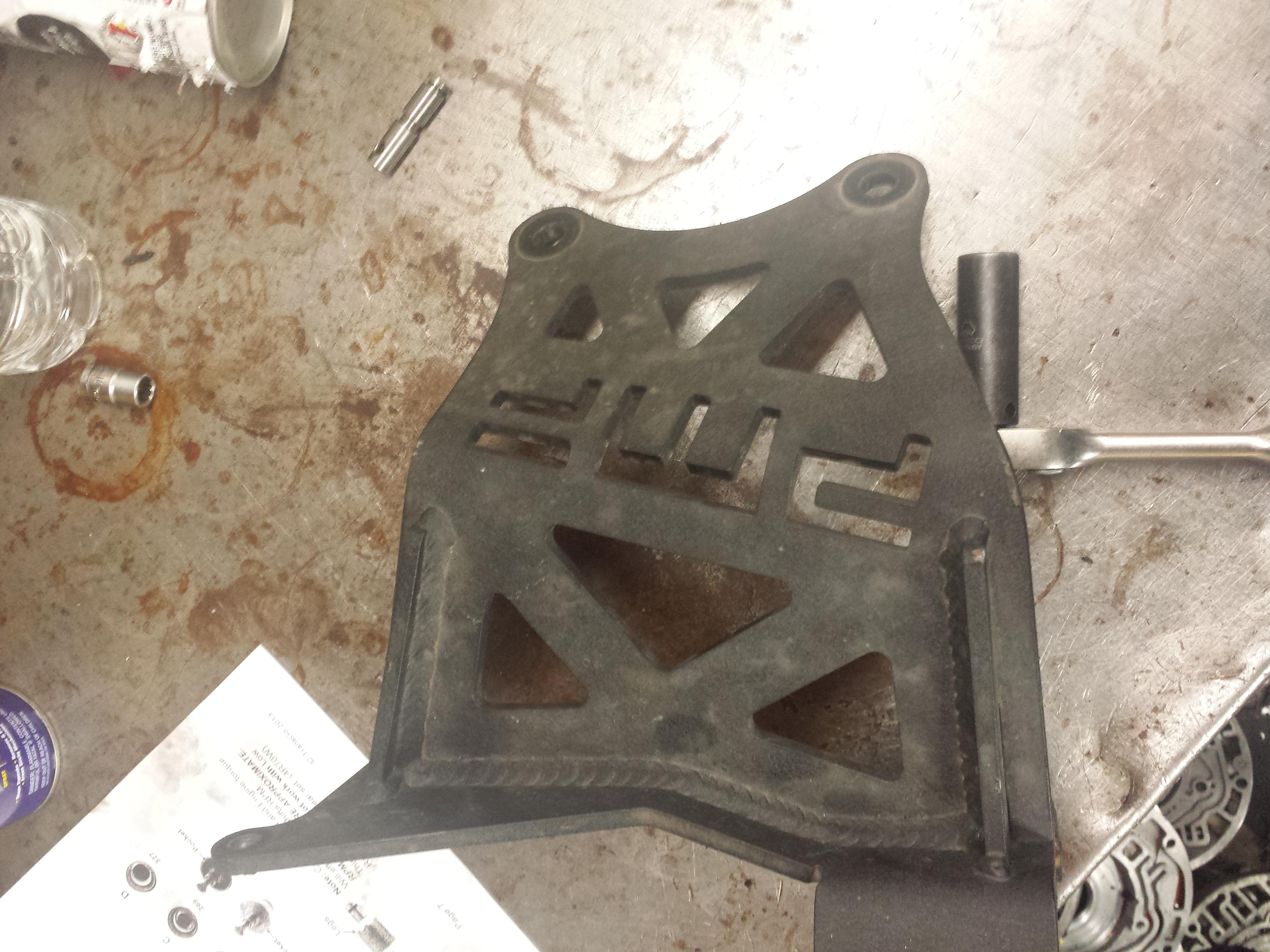

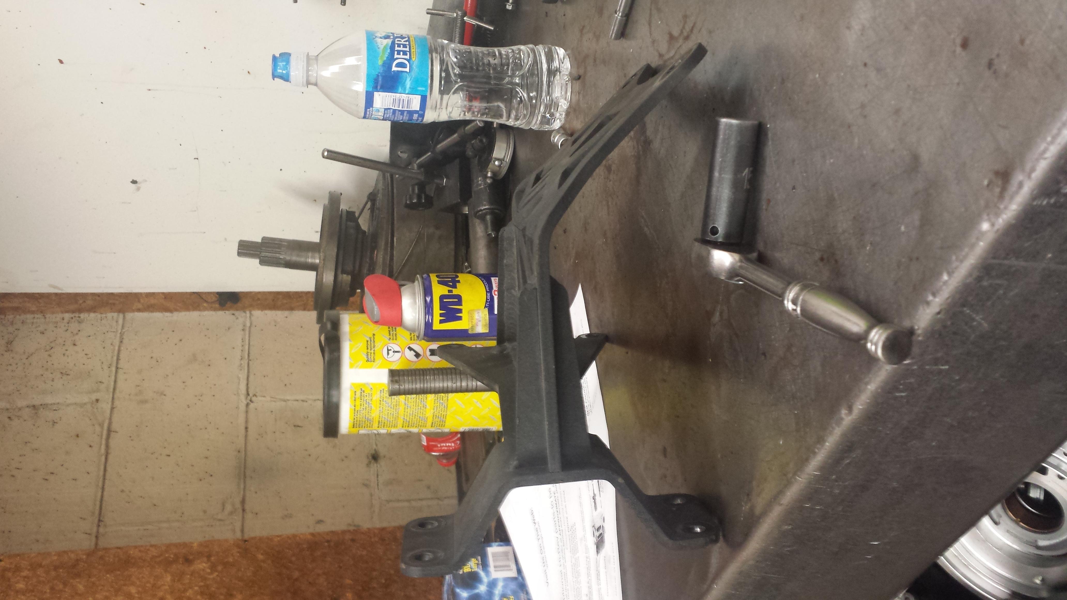

Here is what happens when u hit a deer around 45 with pmf dual center center bracket. Those pretty letters actually make the bracket weak.
It would have bent either way. The only way it have survived would have been to extend the gussets further down the plate or add an additional one to the center also extending further down.
