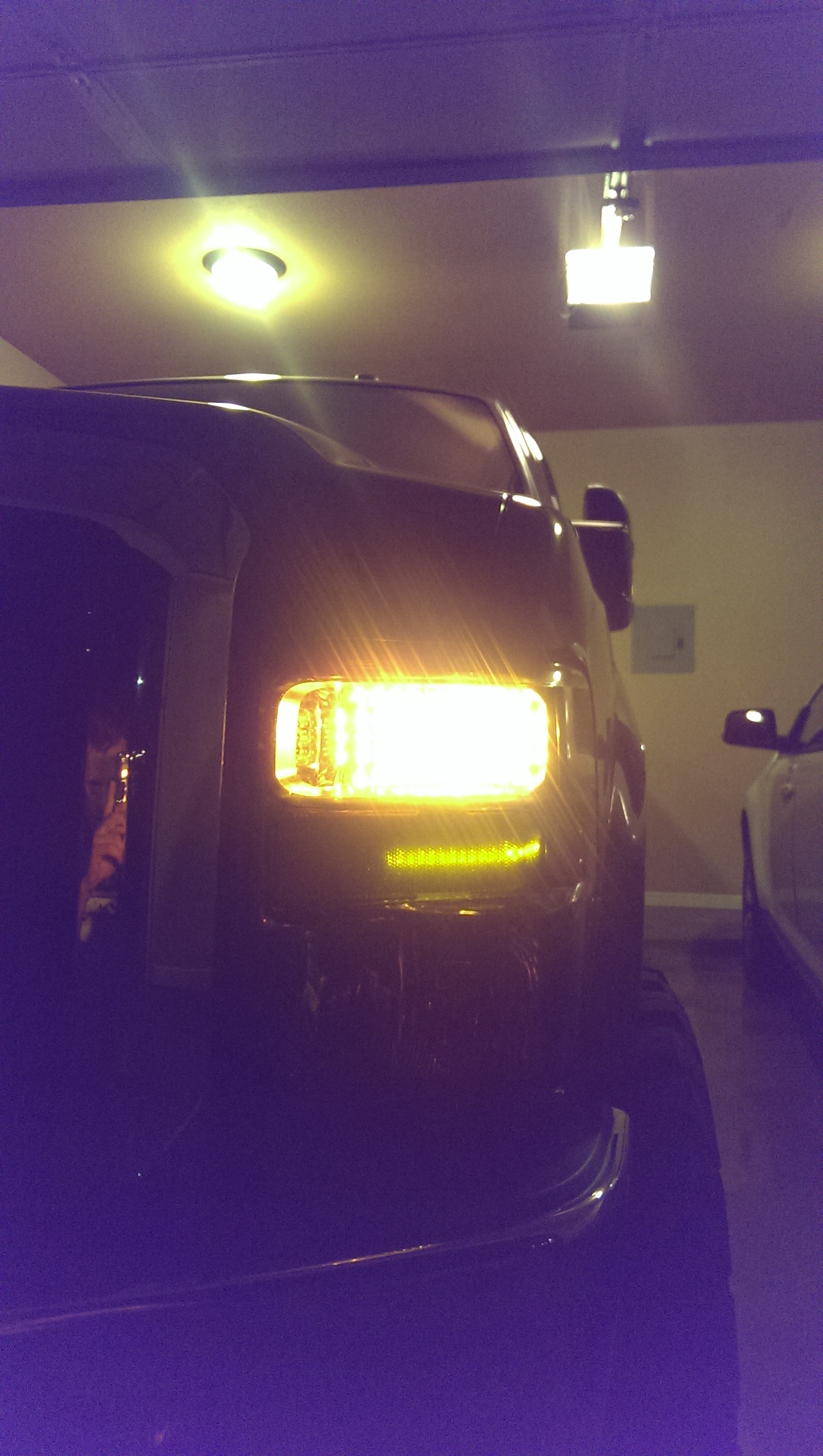

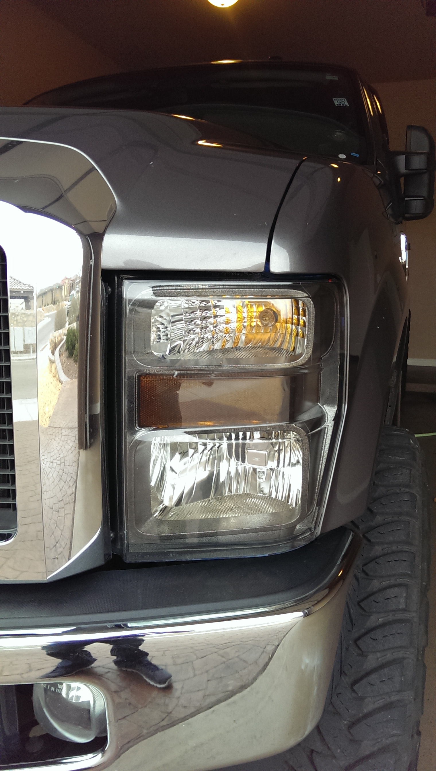

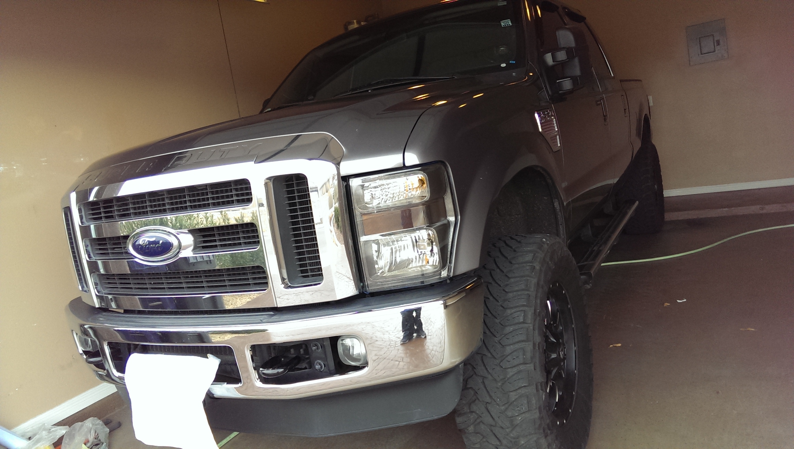

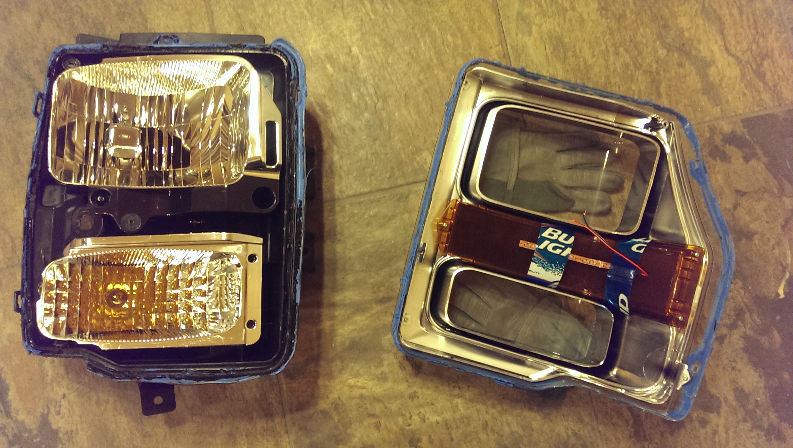

This is how I did mine using plastidip and a set of 6in amber leds but my biggest mistake was not removing all the factory glue and using blue silicone on the first run.. But ya learn something new everyday!

No I did the poor man tint.. I jus cracked em open and used flat black plastidip from a distance and spayed 2 coats let em sit for 5 min between coats then 4 good coats of glossifier taking my time to make sure I didn't create any runs in the paint.. Let em sit over night then sealed em up let sit over night and good to go!! Was a great fun project.. Jus take your time busting em open and clearing out the old sealant..

As u can see in this photo there's two separate housings and IMO if you left the reflector out it would look kinda goofy.

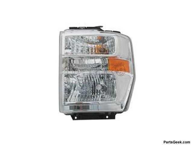

What you could do is find some E350 headlights. They have only a partial reflector...

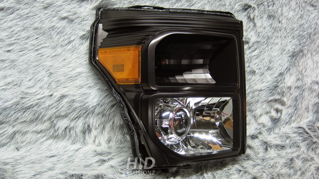

I really like these... Obviously they are 2011 headlights, but same ideas....
and these
