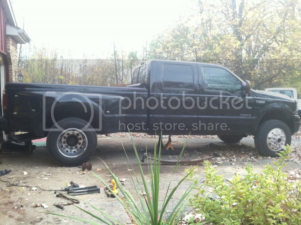

I just swapped out my rear leafs and dropped mine down. Pulled out F550 leafs for a pair of factory leafs, and went to 1.5" blocks instead of the 4" blocks. I was tired of how high mine sat, and it wasn't very high compared to some of yours. LOL

Do you have any current pics now?
So the F550 leafs were the rear or X codes up front?

Didn't touch the front, that has a leveling leaf and was left alone. I had 550 rear leafs with 4" blocks and the rear was 3-4" higher than the front. Those leafs are much more flat than the factory rear springs, so I had to drop the block size down and I wanted it to sit closer to level rather than sky high in the rear.
Here it is when I was wrapping it up, 1 1/2-1" higher in the rear than the front.
