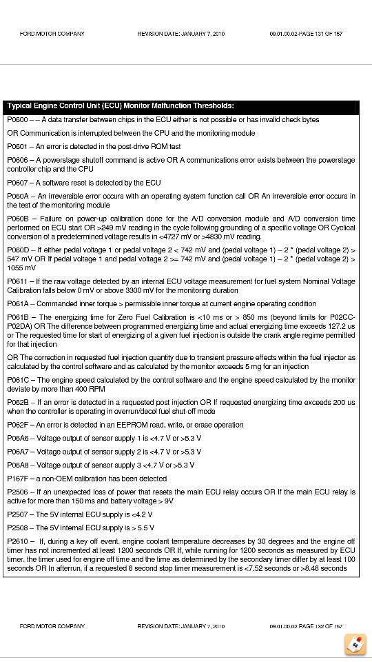

Here is a code list I found a few days ago p0167f non oem calibration detected.. http://powerstrokearmy.com/forums/showthread.php?t=45314

I can tell you I have run codes on trucks (my trucks) all the way up to the 6.7 with Ford's IDS software and no such code or indication of any non OEM tuning was there. Ford dealerships BS a lot of people into that and make them beleive it. Plus non warranty labor rates are much higher than what ford pays them to do warranty work. That is why they don't like it.

So this shot of a pdf that is straight from ford doesnt exist?

Not saying that PDF or even code does not exsist but saying I have purposely looked for that code on tuned trucks and it has never came up. So if it does exsist it does get tripped with tuners I have used like SCT, H&S, Edge etc...

Did you look while the tuner was installed or after it was removed and returned to stock?

Wonder what triggers it then or if the tuners can skate around it? Just curious is all. Like I mentioned, ive read about being denyed do to it. Wonder if its just the non customizable tuners?
