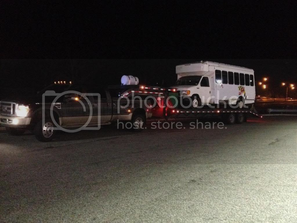

well its done. i finished the insatall at 3:30am this morning.
truck runs awesome. those 73/59s spool like stockers. i didnt really run it hard as i want to give the chargers alittle break in period.
im planning to go to maryland sunday to pickup a e 450 i purchased, so that will be a good test. but as of right now, spool up is night and day compared to what it was.
mainly i feel because of the boost leaks that are now fixed due to junk uppipes and manis.
ill be towing a 28ft goose neck trailer with dual tandems. coming home im prolly going to weigh in at a total of 30k.
all of this went into the 450?
yep. motors built .020 delipped pistons, z gap rings, colt cam, heavy valve springs, p rods, bd manifolds for 6.0, uppipes, wastegate, ported intake,deleted,3" cold cac, barder 73/59 compounds, built trans.

ok so i went to mayland last night.
truck ran fantastic. 60-65mph all the way down, and back. (488 dont allow much more without the engine screaming)
truck was getting 11.3mpg on the way down, and 10.9 on the way back.
egts never went over 850 degrees. this was running on the hd 300 tuning bracket. set on street. (which is 1 down from the 300 tune. 225hp?) boost was 30-35psi on any grades we pulled.
any questions just ask. i have to get to work. heres a picture

Wow, that is extremely impressive.
