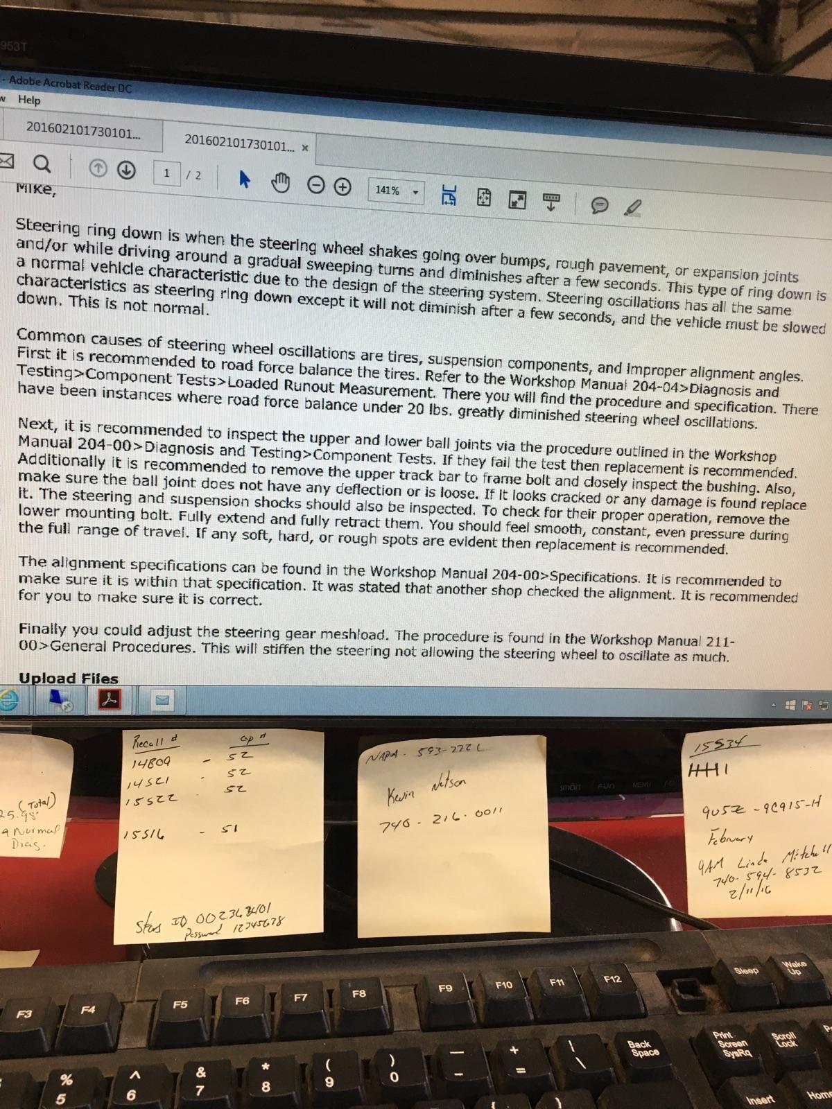

Yes they first told me tire pressure I called bull $hit. Took it back again they said nothing ring tires are fine we can't get it to do it. Took it back again they said everything is fine only thing we can do is align it and that will cost you. So I took it to the reputable shop down the street and paid 25 dollars for alignment check instead of dealership 115. And they said it was spot on. So went back to dealership and they are baffled. So they called ford's tech hotline and this was ford's response. See picture in next post

Friday night you would have thought the cab was gonna fall off it was so bad. Went and drove over the same spot 15 times tonight trying to duplicate it with video camera and it never did.
