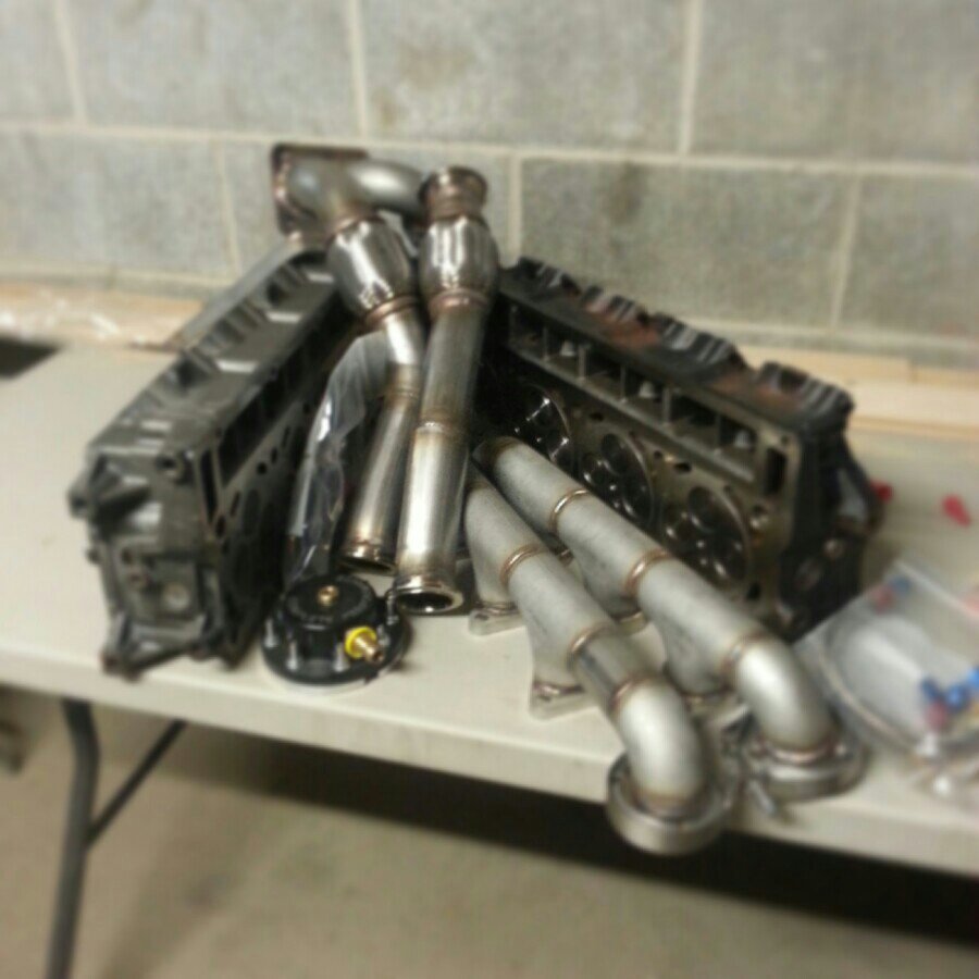

Thanks for the pic... so you just install that over the OEM gaskets? That must just crush.
Those look like UFC heads? Do you know what kind they are?
I really like the Oring option. It seems to add a little extra give for when the studs stretch under high cylinder pressures
Yes just install it over stock gaskets. UFC heads? Fill me in? to the best of my knowledge they are just stock heads.

So, on "o-ringed" heads that just crush the OEM HG, how are the rings attached to the head?? Or are they attached to the head?? I've never really looked into this before and it seems like a good option now that I look at it.
I think the grooves are machined and they are set in there. This is just based off of looking at mine. I am not a machinist nor, do I know the correct answer... but who knows maybe I am right LOL
Best picture I have. Groove is cut into the head and the wire is a slight interference fit.
