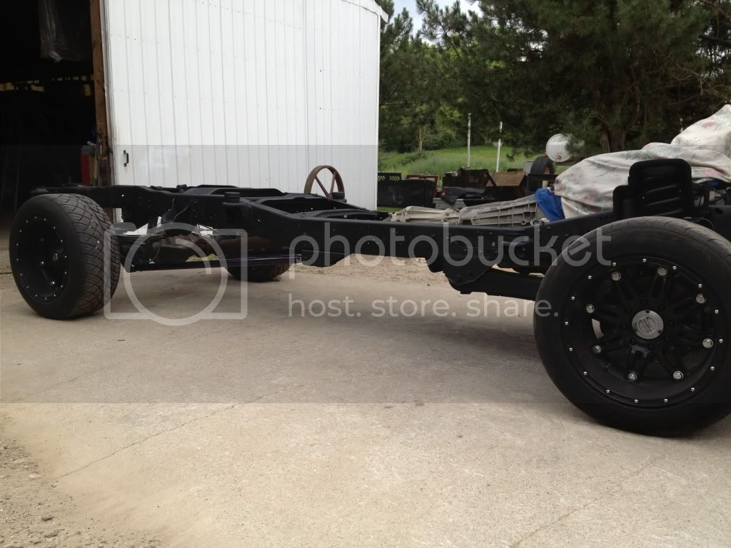

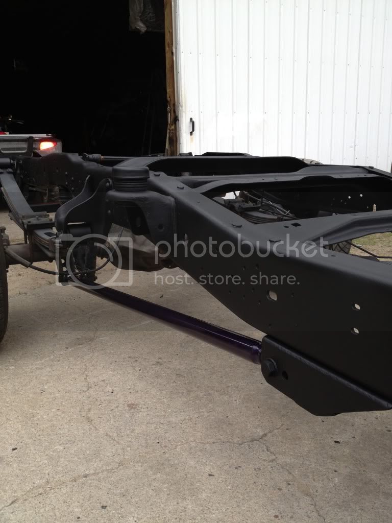

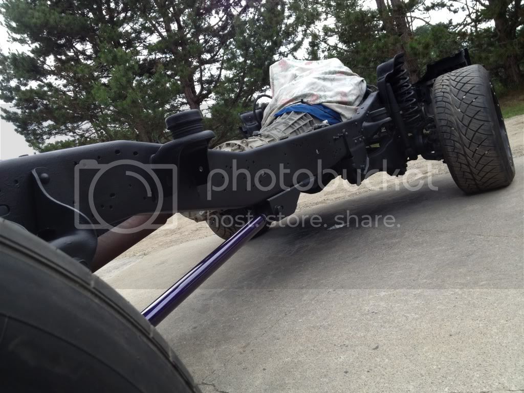

I just coated my frame with rustoleum rusty metal primer, the frame was clean not much rust but the rusty metal primer is thicker and holds better IMO. Rolled/brushed on 2 coats then rolled/brushed on 2 coats of rustoleum flat black and it looks great. We've done the same on ever truck we've had and it holds up great even in Michigan winters.
Any undercoat I've used sucks weather it's a do it yourself undercoat or places like ziebart or the like it just peals right off, por15 is wasted money IMO also.
I've always had good luck with rustoleum sem and 3m if you want to spray paint use 3m or sem self etching primer.
Here's a pic of my truck freshly painted its surprisingly hard to scratch off.
