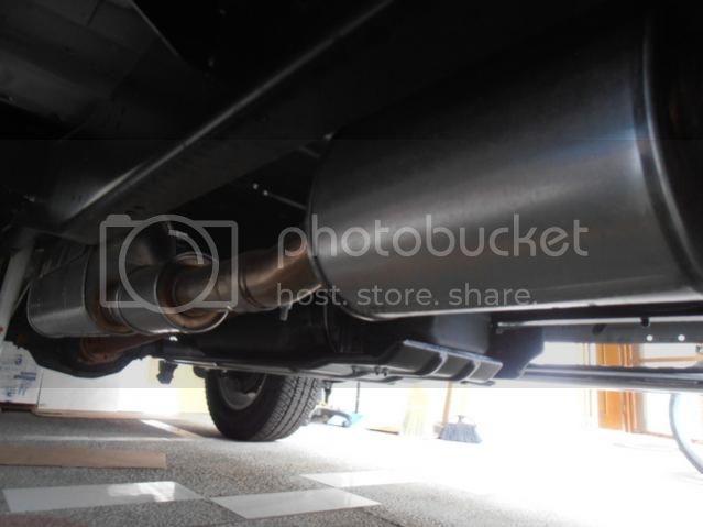

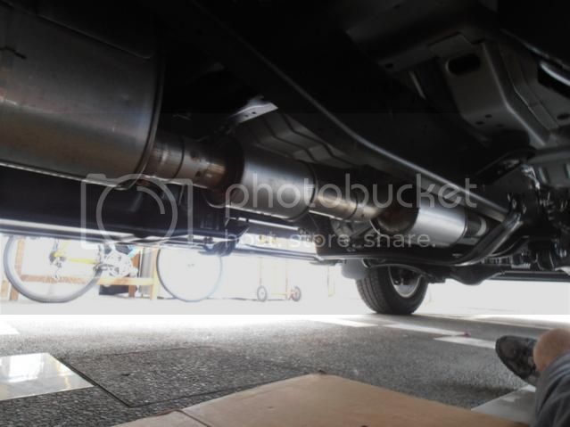

This is what it looks like under a Mexico truck.
That would make for a perfect delete pipe- totally OEM.
On the ford Mexico website, they list a 40gallon tank for the f450. That would be an ideal choice if it fits shortbed trucks. Otherwise, yeah it's the same 26gallon tank.
I'd bet a good ford parts guy could find an option for a larger OEM tank if one exists...
