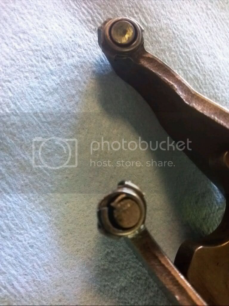

Yup. Is that exhaust or intake rocker? You'll need a new bridge for the top of the valves. I'd send you some parts but it would take some time. I'll get you the part numbers tonight, I got extra stuff in bags.
I ordered the complete asembly for both sides 209$ each, be here in the morning.
Thanks man, I will get with you about that injector you wanted as soon as I determine how many I have left, just incase I break another one...lol
Should've ordered just the arms, about half the price but at least the new assembly is good to go.
I priced them from ford
33$ each rocker
62$ for each complete intake and exhaust assembly
209$ for complete side with pedestal ( all 4 assemblies)
I was installing the new plastic clips on the old ones when I found the bad tips.
