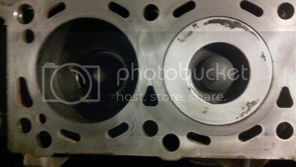

This is what mines looked like after i got done. Razor blade, flat scraper, 600 grit and 1500 grit still had some pitting but hope thats ok. This was the biggest PITA of the whole build. **** block prep.
p.s. FYI if you turn the block over you can clean the other pistons. found that out when turning it over for the valve train

Yeah, I'm not worried about cleaning the tops of the pistons off, since they'll look just like that after about the first hour of running it.
How did you sand it Kenny? With a block of some sort I hope, not just by hand...?
My headgaskets have been off the truck enough that I doubt the ones on there are "stuck" to the block very much.
