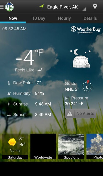

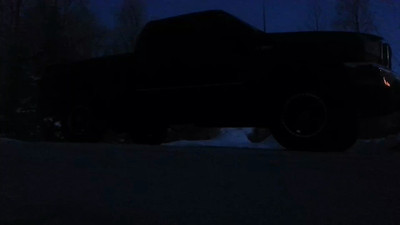

Just started mine yesterday morning in -8F ...my heater plug was iced up so I didn't plug it in.....Matt @ Gearhead has the tuning on this new Hydra nailed IMO. Very little smoke or haze. I'd take a vid...but it's dark :)
