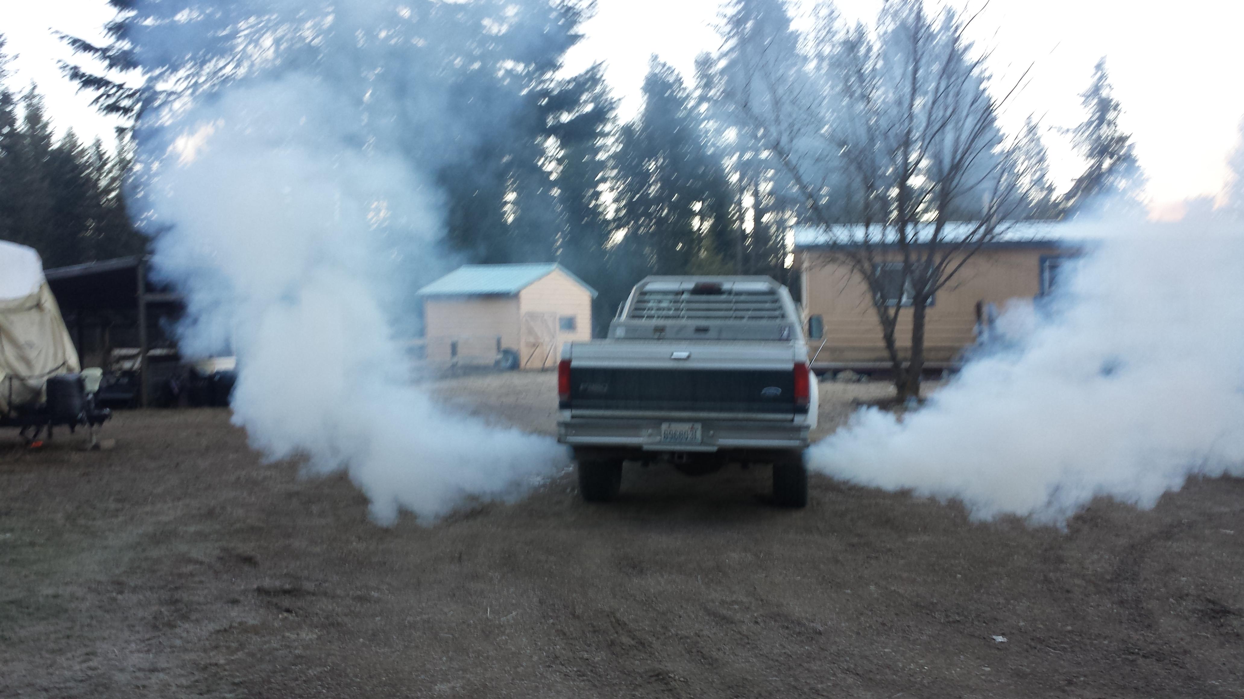

12 degrees this morning, truck hadn't been driven since Friday evening...

Mine smokes white on a cold start, but damn it's not that bad. Even without working glow plugs is wasn't that bad.

Yep, that's exactly what mine looks like just out of one exhaust pipe. At least until the oil temp comes up. I switched to Rotella 10-30 and got easier starts, same smoke but goes away faster. Haven't had much time to do more diagnostics, been working on my classic Buick over the winter. :)

Living up in montana I switched to Rotella 5w-40 and it cut my smoke down alot. Even with the big sticks and not being plugged in it will just lightly haze.

my six for looks like that when it start in negative temps.

I guess my pickup didn't appreciate me showing off her smoking habit. She thanked me by not wanting to start when I got off work last night. Cranked over fine and had white smoke out the exhaust so I knew it was getting fuel, figured maybe the glow plug relay gave up on me so I tried to jump the relay with a wrench. Turns out I was right, as soon as I tried to connect the switched side of the relay to the hot side the hot side terminal broke right off with barely any pressure on it. I got to do the walk of shame to Napa and fork over way too much money for a damn GPR.
