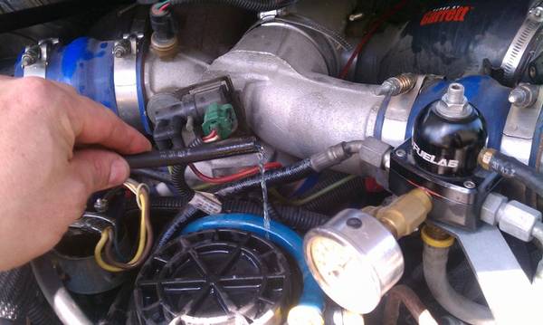

Charles how much fuel did the regulator piss out when it ruptured?
Chuck already answered, but I have a photo of mine when it ruptured in April. I had mine dumping in the valley since the install, for the run away reasons he described.
It would not leak KOEO with 65psi on the gauge, but would idling. I have no idea if the flow increased....drove it home 20 or so miles like that.
Tom S
3,365
Wow that is very steady flow. Looks like a smart idea to have the hose on there to control where that fuel goes if it ruptures.
