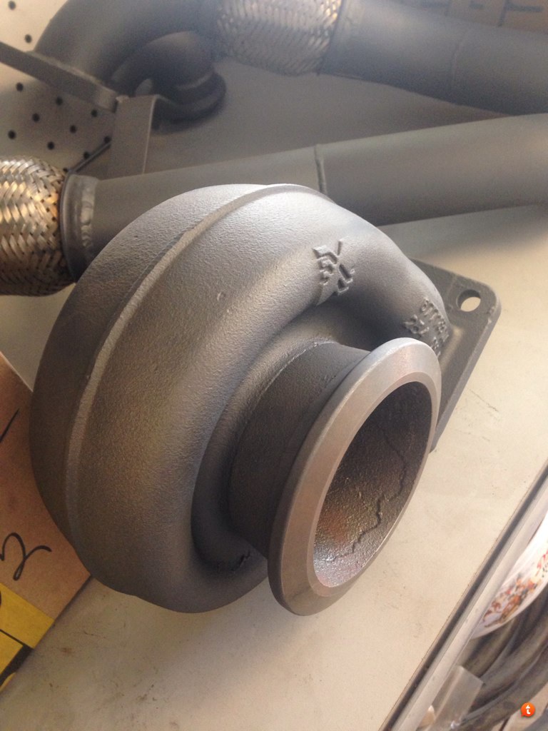

I found out that the downpipe needs to be modified to run the 64.5mm fmw....I didn't realize that.
With that particular housing we had to cut the down pipe flange off and move it 1 inch, that was it. Not sure on other housings but this one had a longer than normal exhaust housing outlet.

Sorry guys, this is the 68mm turbine with a 1.10 housing. Long story short customer was stranded at TS and we ended up with truck here then he wanted to do some upgrades while we had it. This is what we had in stock and wanted to give it a try to get the customer back on the road. Results so far are impressive, a smaller 1.0 or .91 would be great with these 155cc injectors!

HTT how is offering that standard outlet .83 housing so you don't need to modify the down pipe
