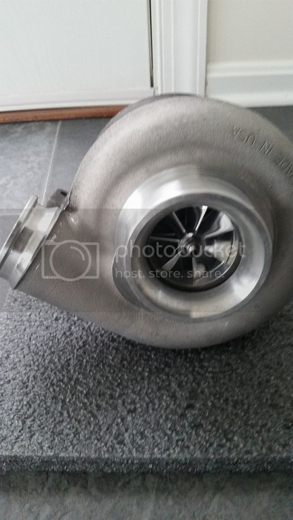

Is the 62fmw the only one that comes with the straight boot housing? Here's a pic of the 62fmw

The 62FMW is available in v band or hose outlet. The 64.5 is only v band at this time but a hose outlet is in the works.
