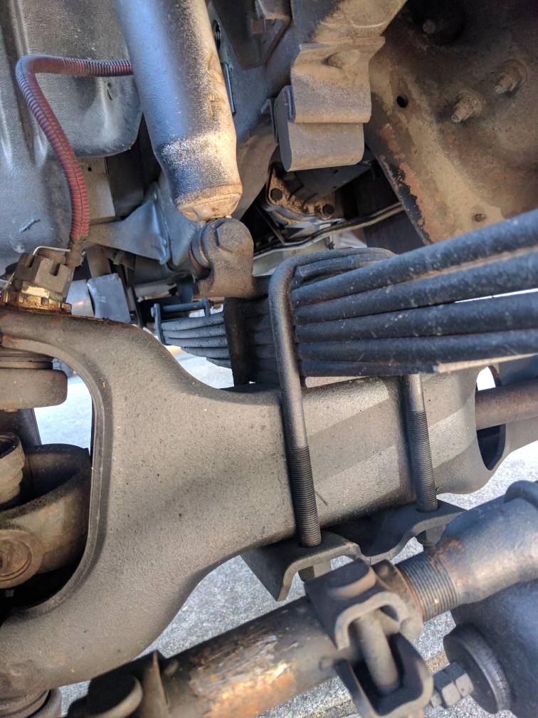

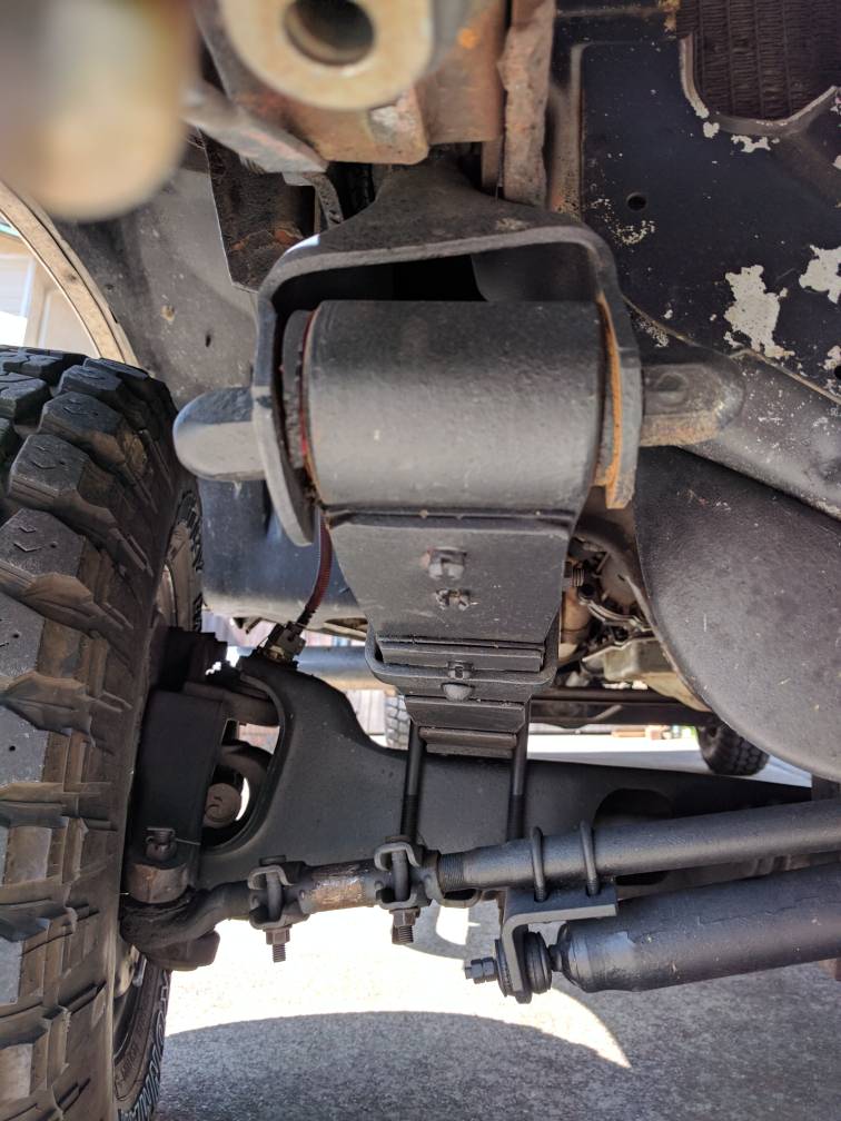

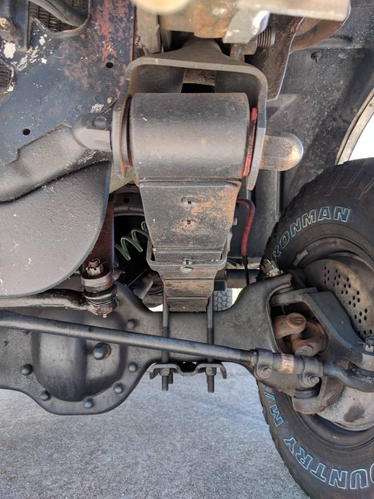

Both the front shackles are bent, can the leaf springs be adjusted left and right on the axle?Or is there a pin in the axles the leaf springs align with?
Part of me thinks whoever messed with them last didn't align the leaf springs so it put to much tension on them?
Obviously I am going to replace them but don't want it to happen again. Do these look like the stock size shackles?
Sent from my Nexus 5X using Tapatalk
The reason you are twisting the front shackles is due to the spring pack. Since the D50 is a so called "independent" suspension (TTB50 = POS), the leaf pack is preventing the leafs from twisting. The shackles are absorbing the twisting action. The design of the POS TTB50, the leafs not only go up/down, they have to resist the twisting/arc of the TTB arms. The F250 springs are thicker than the F350 springs.
How often do you replace ball joints? The upper ones are at an extreme angle. :shocked::shocked::shocked:

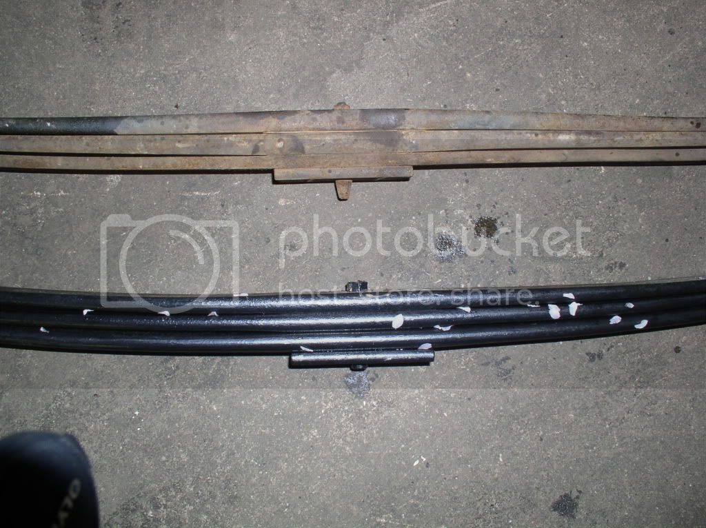

The top spring is the F250 one. Bottom is the F350 one. Notice the thickness in the leafs. The bottom leaf in each pack is an add-a-leaf; the top leafs are the OEM leafs.

I wouldn't recommend playing with a lifted TTB. Getting all the geometry correct will take a lot of work, time, and money. And none of the aftermarket lift springs will act the same as the stock spring pack. I did a small lift on my TTB (about 2.5"), and it was just not worth the hassle.
Tuff country makes adjustable drop brackets. They allow you match the drop of the axle to the spring height. But I still wouldn't play with them.
My advice, like everyone else, is go Dana 60. You don't even need to do a reverse shackle kit. A straight axle swap on these trucks is about as "bolt in" as it gets.

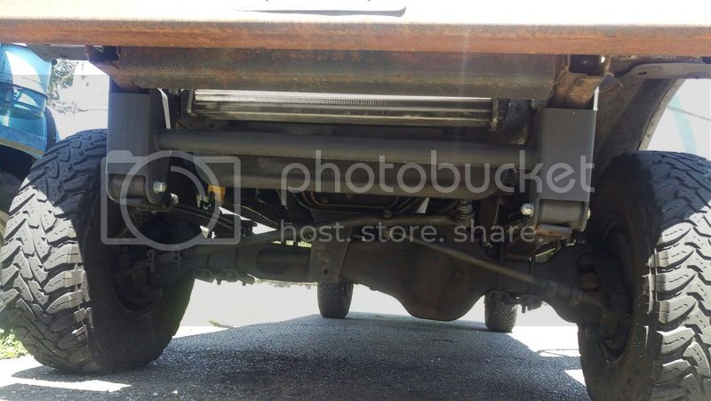

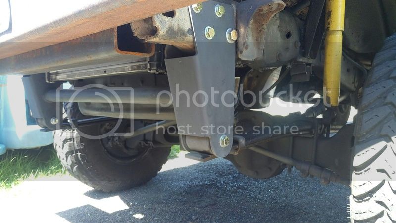

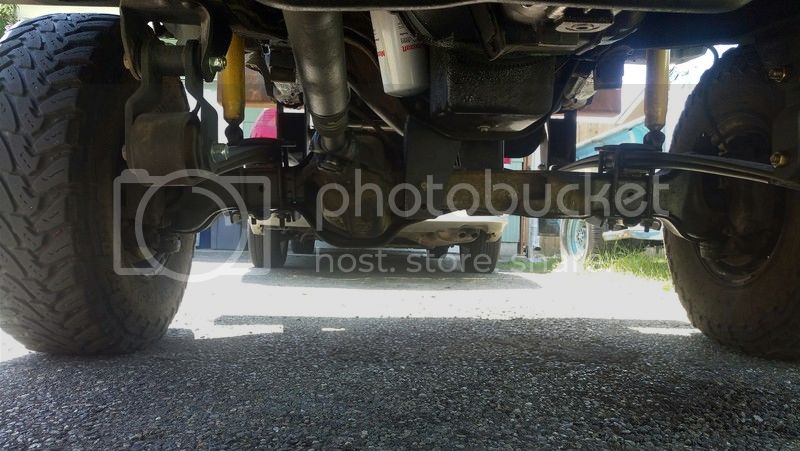

This is my TTB with a 5" RSK. I can always roll a D60 with OBS Springs latter if needed. At this point however I am completely happy with how it performs and I have not had any tire wear or drivability issues. This is my daily driver. I lifted it about a year ago and had the initial alignment and have not needed any other alignment checks.

Thanks for the pictures! I am really not trying to do a D60 swap at the moment.
So if I get the stock leafs, and the RSK in a 5" I should be at 28" from fender to hub. Just like you, if I go with the 3" kit I should be at about 26" from fender to hub (1" higher than my current setup). This sounds right yeah?

DudeManScott if you go with a lower RSK lift like a 3" you would have to change the pivot brackets to a 2" drop bracket. Going with a 3" RSK and a 4" drop pivot like you have now would have the axle beams pointed up from the pivot points like wings on an aircraft versus having them lay flat as they should. In that case you would likely never been able to align the suspension. There would be no way to correct the camber.
