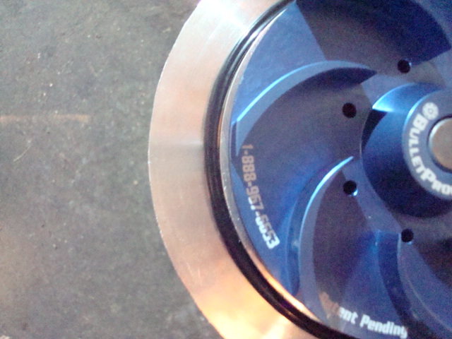

anyone know if the rubber o-ring is suppose to fit snug on it cause the one that came with mine just slips over and is really loose. There's probably around 1/8th gap between the o-ring and the shoulder of the pump....you can see it in the first pic.

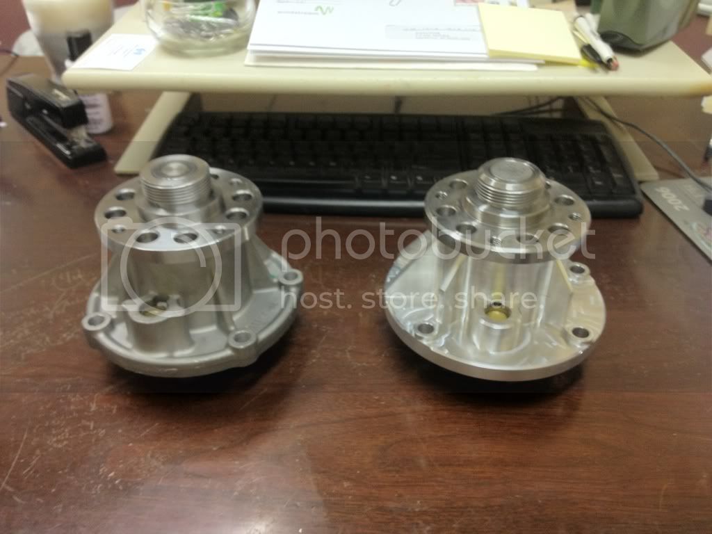

I just put their all billet pump in my truck. It's a shame that you wont be able to see this thing.
Standard BPD pump on left. All billet on right
As long as it doesn't get pitched between the pump and housing you will be fine.
I just put a little o ring grease on it first. (Dow Corning 55 o ring grease)
Like I said earlier....only thing I hate about them is that you can't see the inside from the outside....and now it's worse...you cant see the billet that they use on the outside for the housing now either.:(
Goose
1,026
Lake Martin, Al
What's the point of the full billet unit? What's the cost on that?
Ken said he has too much trouble getting cores for the standard water pump with his billet impeller. Once the testing phase of this all billet pump is complete that is all BPD will offer.
didn't realize they offered a full billet unit over the other one they already offer.
They don't yet. I have the first one.
