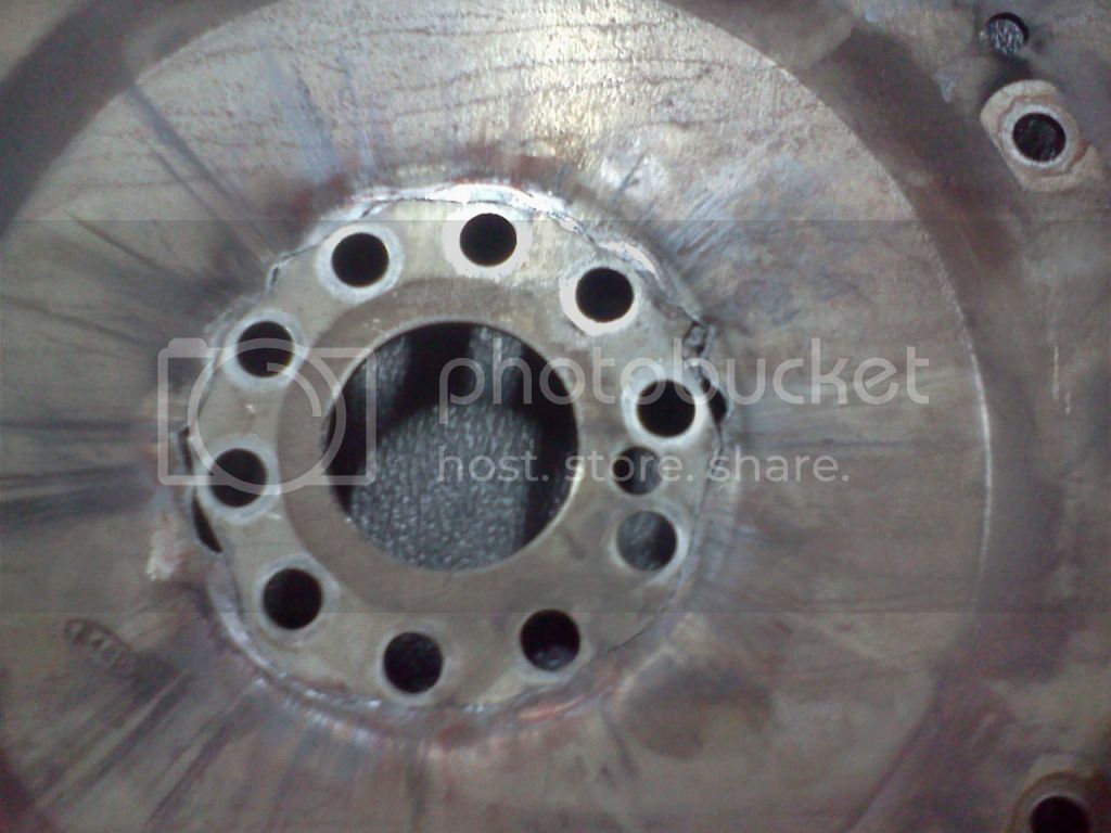

Pull it out. I bet it looks something like this...

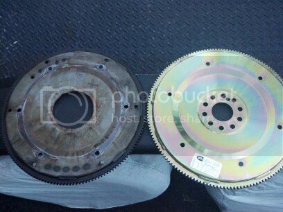

You need to remove the trans, remove that metal ring that the flexplate bolts go through and remove the flexplate entirely. Examine the flexplate closely and you will find the crack. You probably can take a hammer and knock out the center piece.
This is how mine sounded. Although it's not as bad as yours but it still has that "tinny" sound.
https://www.youtube.com/watch?v=_KMjWlIjpzs
And this is how it looked when I pulled it out.
The flexplate on the right is the Precision flexplate.
