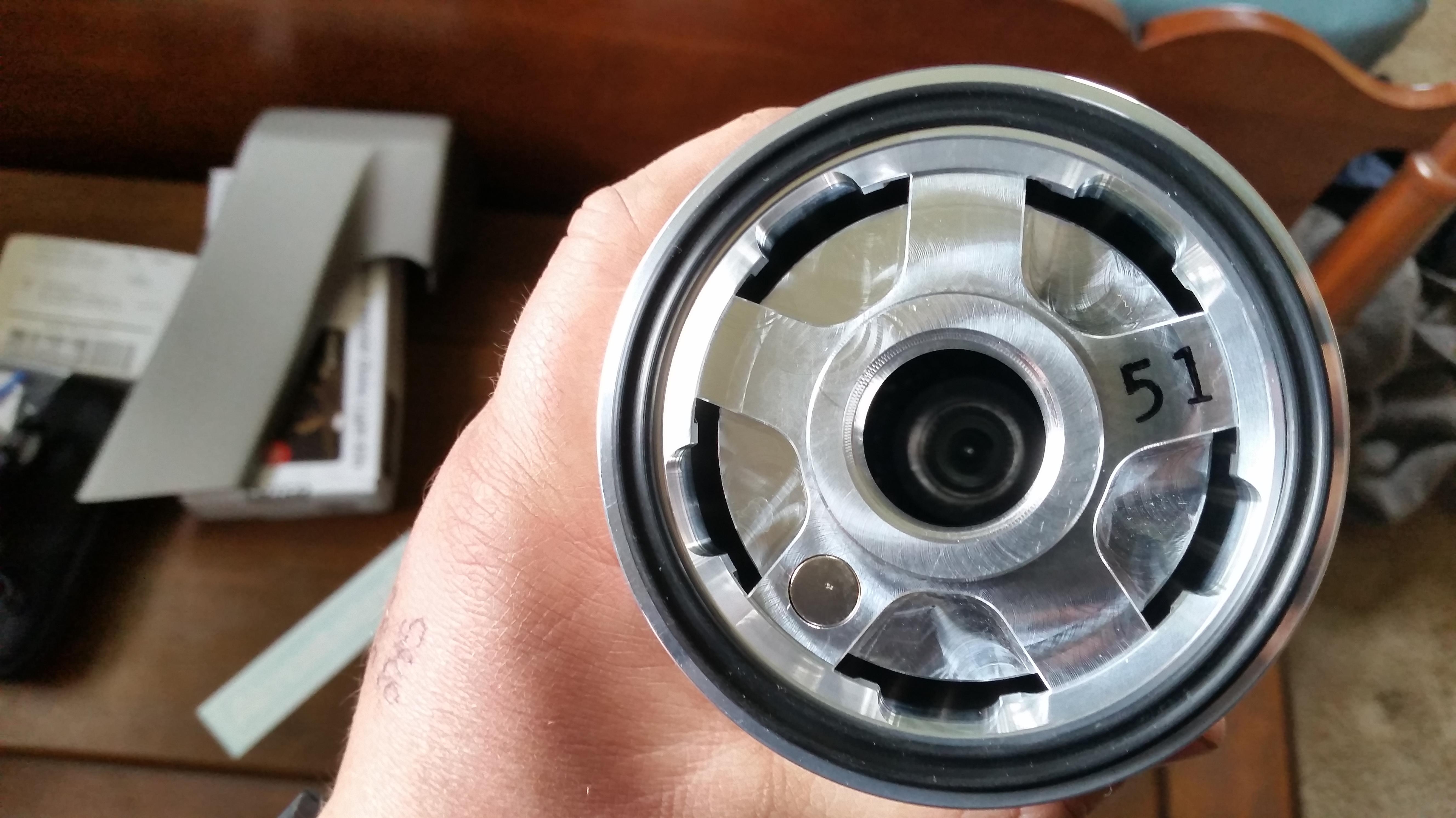

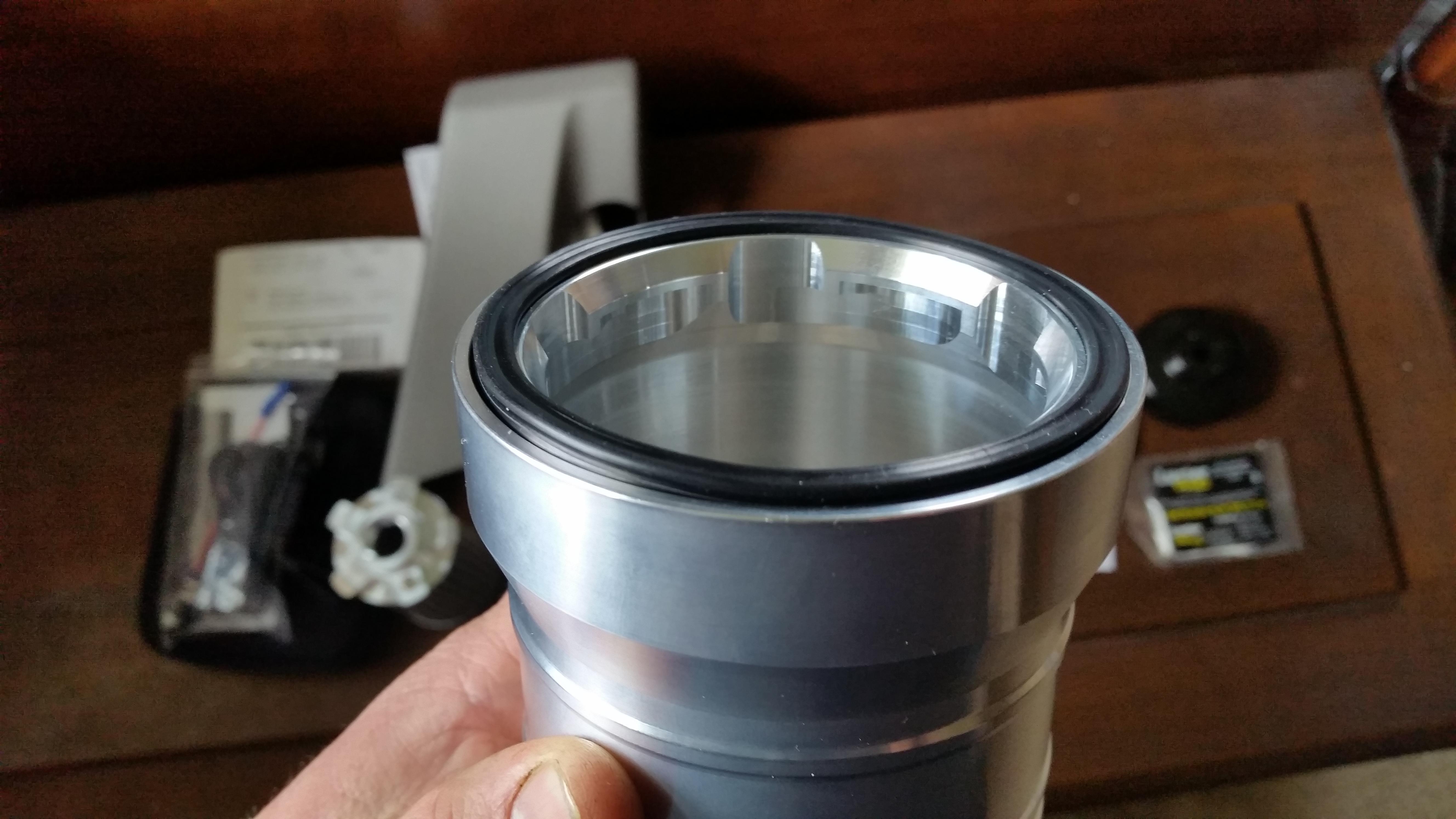

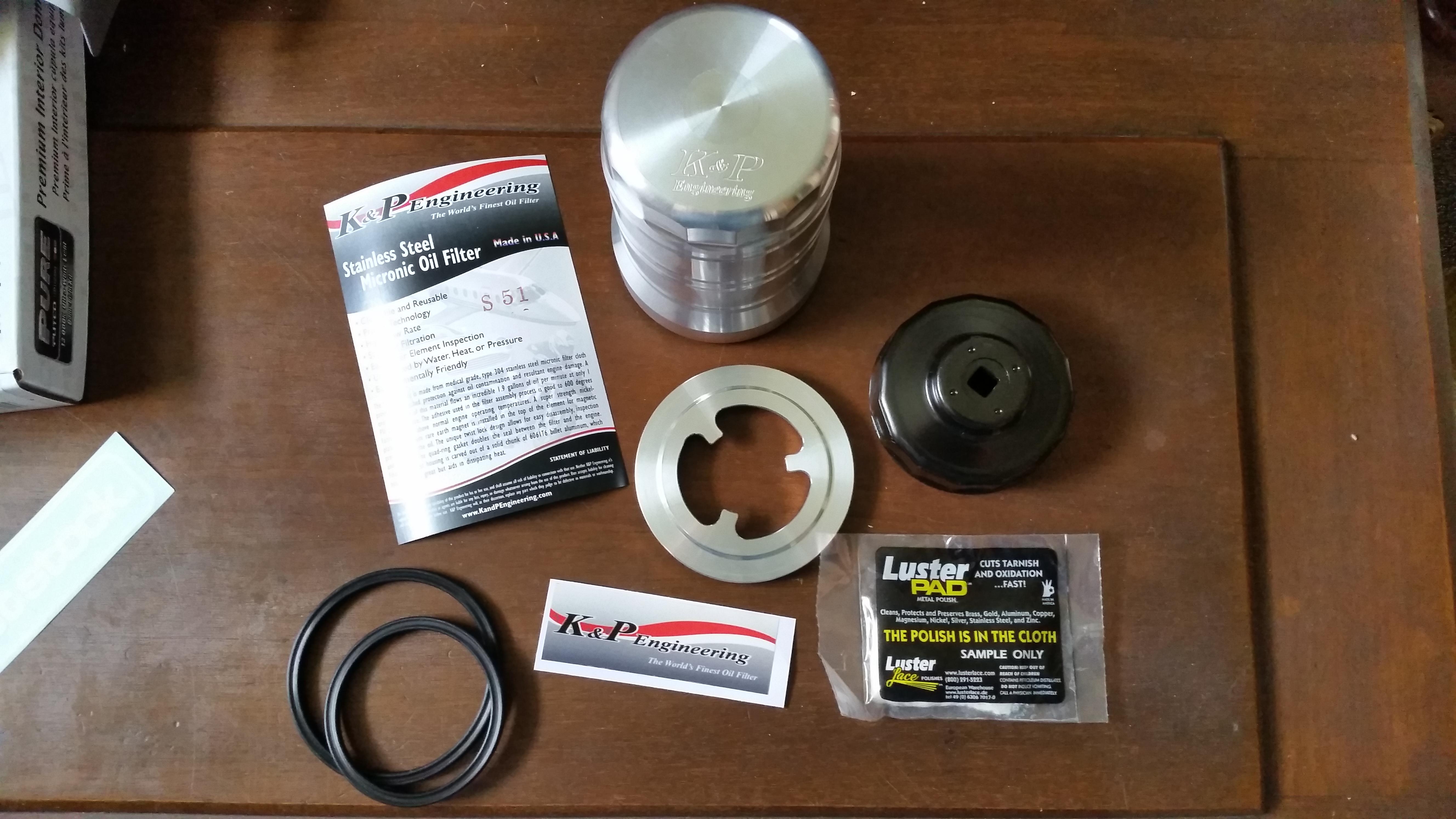

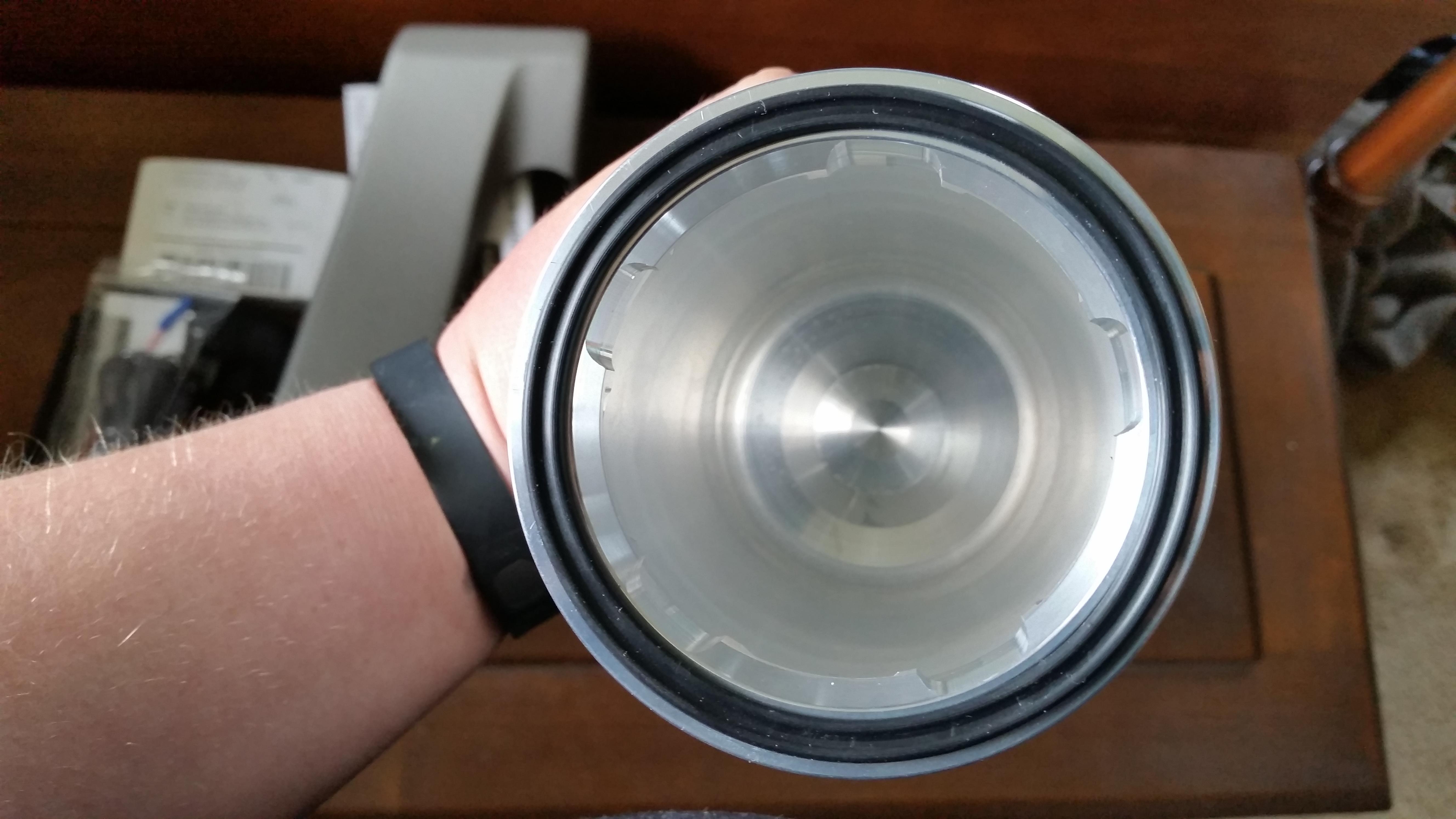

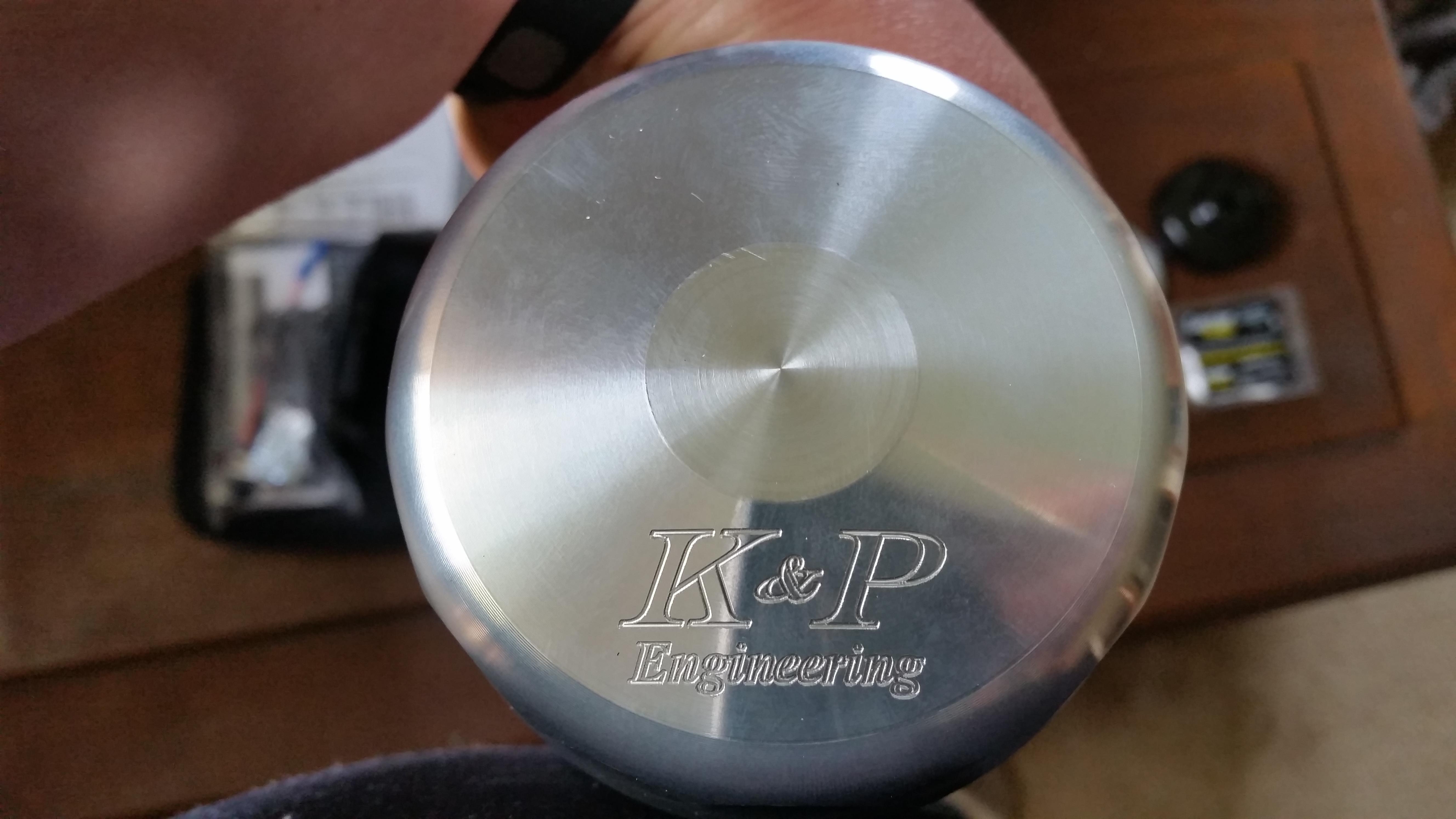

Picked up a K&P Engineering oil filter yesterday from Nate and Unlimited Diesel Performance (showed up just in time to watch them fire up the p pumped 7.3). Took some pictures for anyone not familiar with them. 5 micron rating and flows way more than a paper element and reusable. Just clean them out with brake cleaner every oil change. Also has a magnet to help trap any metal. Pretty sweet little deal. Also comes with an adapter plate to be compatible with the 5.9 and others not just the 6.7 powerstroke. Also comes with a wrench adapter that slides on the bottom and extra rings.

Definitely man. Give Nate a call he'd send you one for sure. I was impressed by them. I think it'll work good... looks good too to match my No Limit IC

Lol I know it's a lot for a filter but for quality and performance wise I though it was reasonable. I actually thought it'd be more after seeing the setup UDP has on their 7.3
