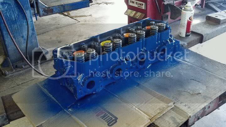

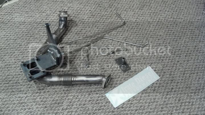

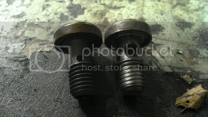

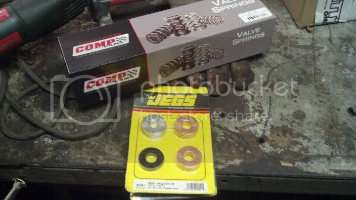

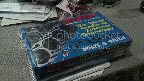

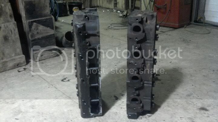

Well I got the heads and decided on a motor color. Here are some random pictures of parts and little things I've been doing.
