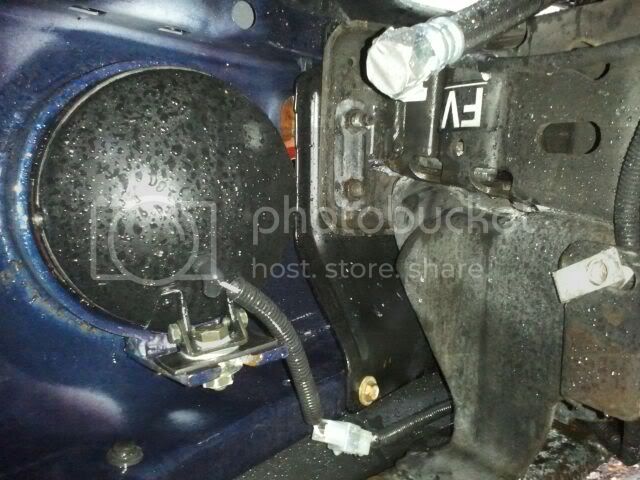

Flo Rida
100% cab on. :D
If you look at the firewall on the driver side, you can see where it's hammered back for clearance. It'll be hidden behind the firewall heat shield, and hopefully never seen again.

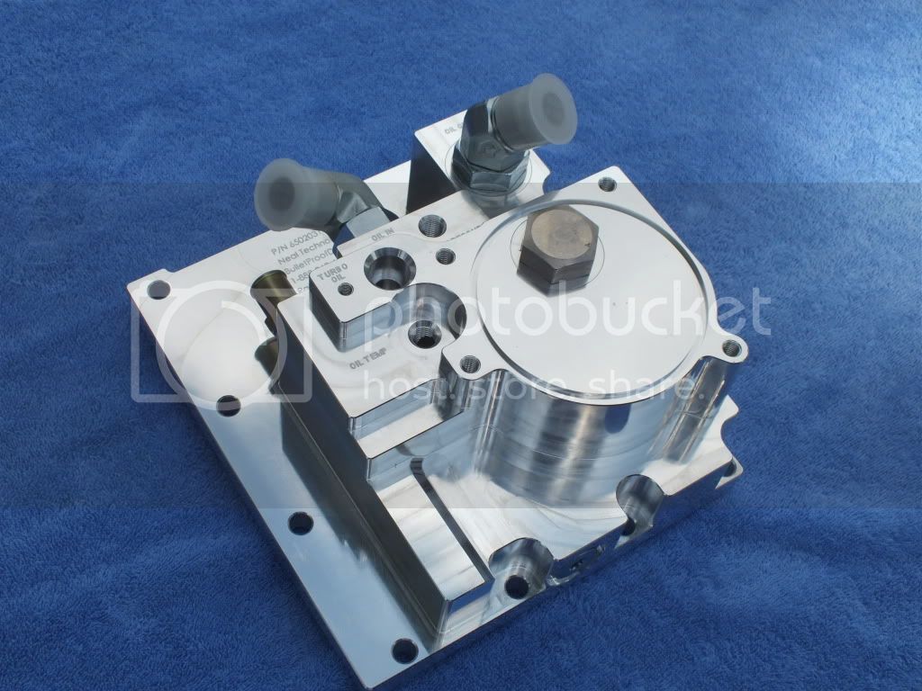

You know how when a girl gets engaged she shows off her ring to all her friends?
My friends, I present to you the 6.0 Powerstroke engagement ring.......

Flo Rida
I had the exact same thoughts. For a lot of reasons, it seems accurate. My friends went "ooh" and "ahh," it's high quality, it's blingy, it's expensive, and more than ever I feel like I'm entering a committed relationship with my truck. LOL

Is this the cooler relocation kit?
Yessir. The OEM oil cooler "block" is replaced with the BPD unit pictured and there's an air to liquid intercooler that mounts behind the AC condensor. We're about 75% of the way through the install and once completed I'm going to organize my thoughts and pics for a write up.
I know it's been said before, but everything in this kit is top shelf. It's very apparent that no corners have been cut and the install has been straight forward with the exception of some self-induced challenges (like replacing one of the BPD fittings with a NPTxAN fitting for the EGR delete).
That is straight beauty right there and YES getting this kit definitely signifies that you are committing yourself to your truck. LOL LOL LOL
