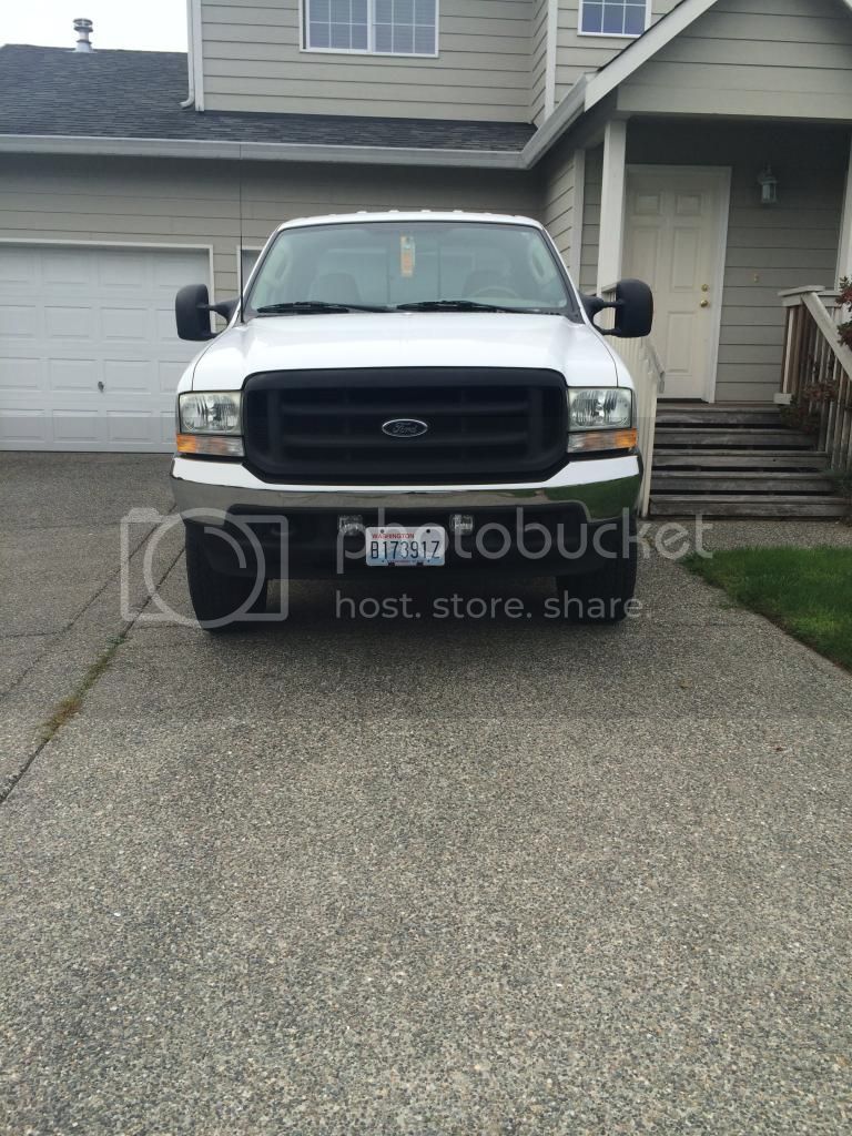

I am wanting to do a billet grill with some clear headlights. Anyone have some links or options? Not doing a 05 conversion, just want clears or smoked.

Here is what I did, junked my chrome one and picked up a plain grille for 30 bucks. I will be painting the chrome bumper white and doing smoked lights. Will really bring it together!

Why not do an 05 front? Imo, it'd look better if you're going to paint match. All white grill and bumper looks bad on a white/tan truck imo(applies to any 2 tone).

I don't see the point in spending that kind of coin on a front end. If I wanted that type I would have bought that year. I like the classic superduty look but with a hint of creativity. I just don't want my truck looking like everyone else's when it comes to front ends.
The grille will stay black but the chrome left on the bumper is going white. I could never do an all white front end but I would like to put the smoked lights in to see how it looks with the chrome still there.
