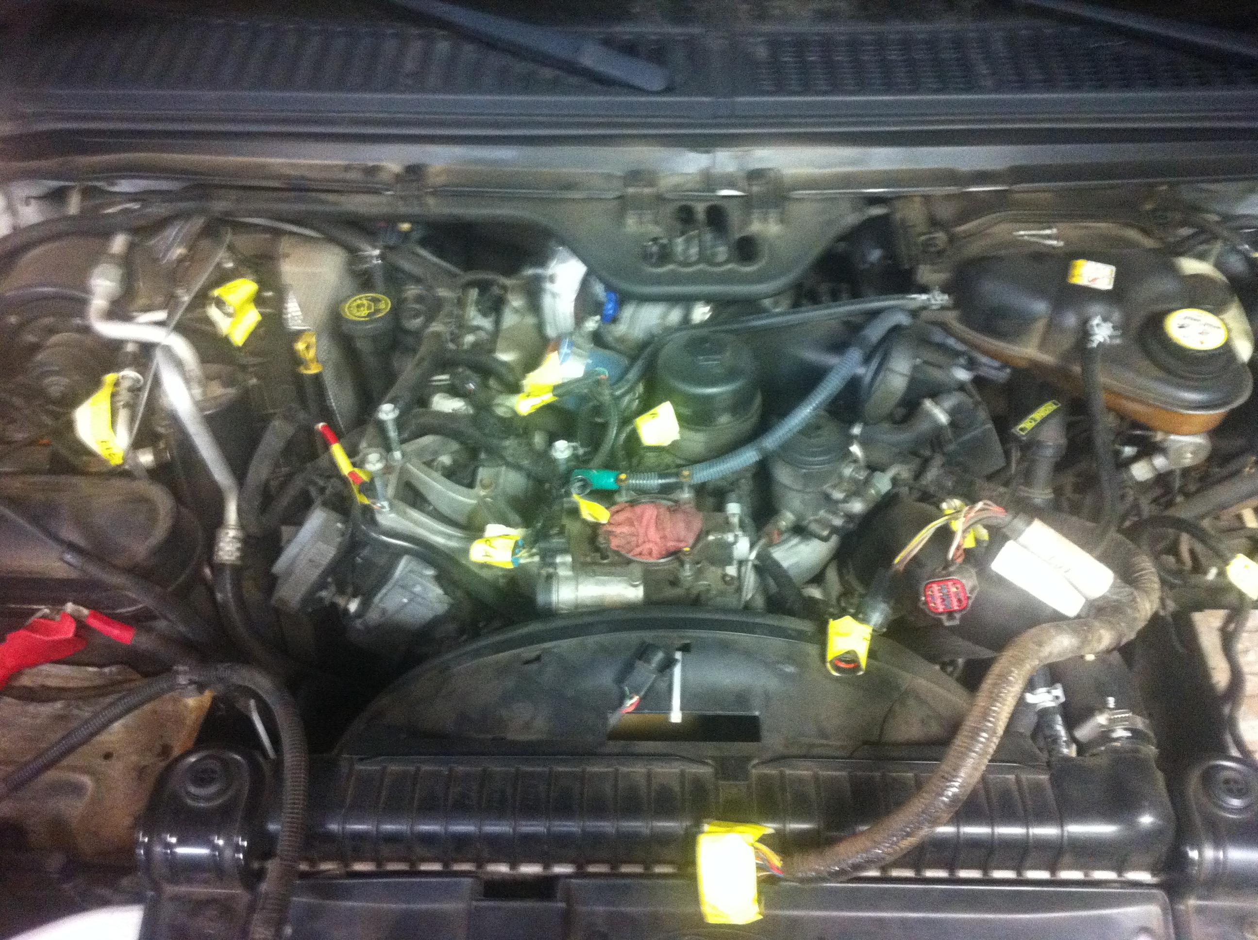

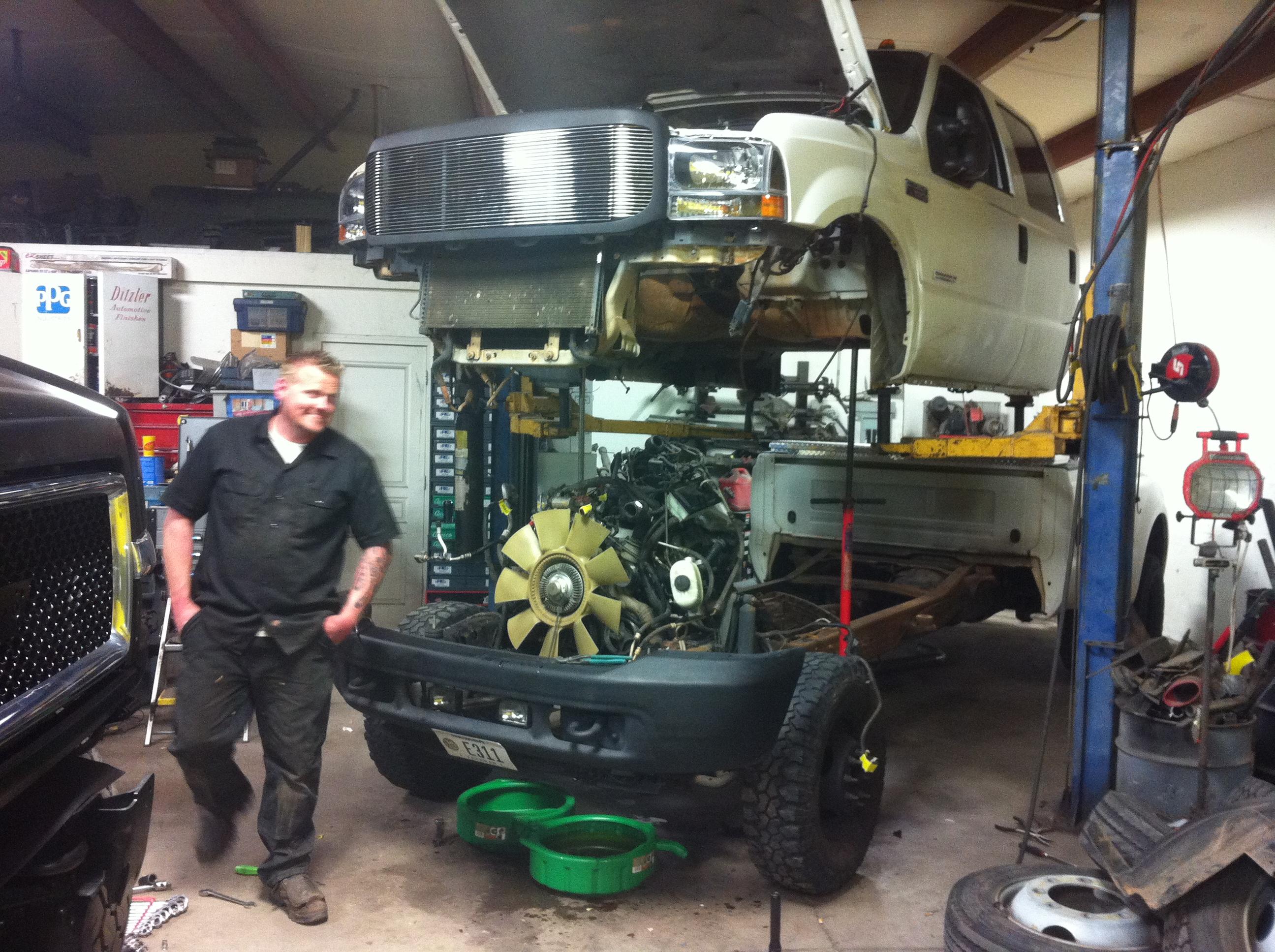

Started it finally, got a couple shots of the tear down, and the other truck that was slowing my process down.

Yeah for the most part. I had a couple hang ups, but we got them before they became a problem.
