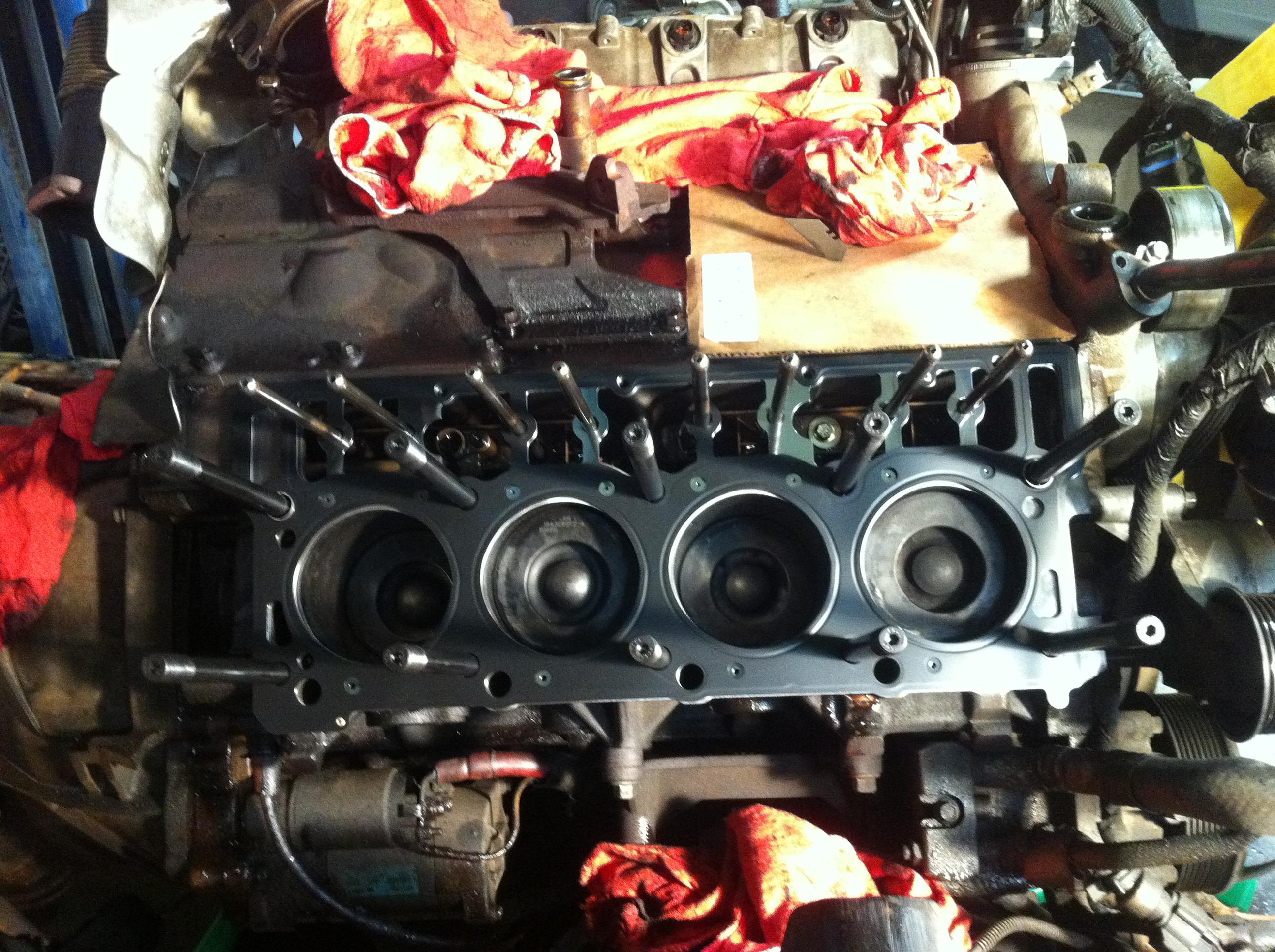

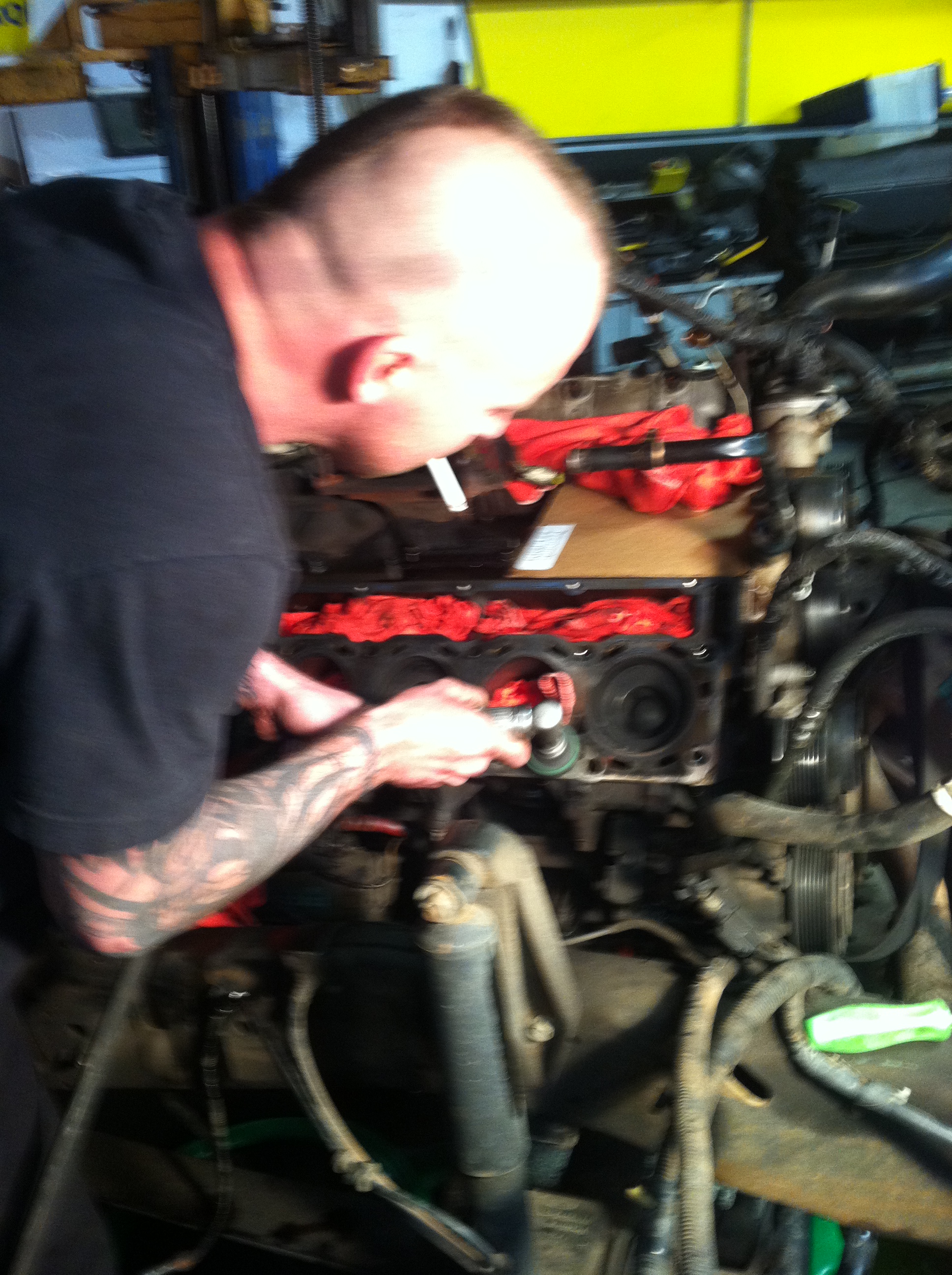

Well got the heads back on last night (at 1 in the morning) got some pics of some of the work enjoy

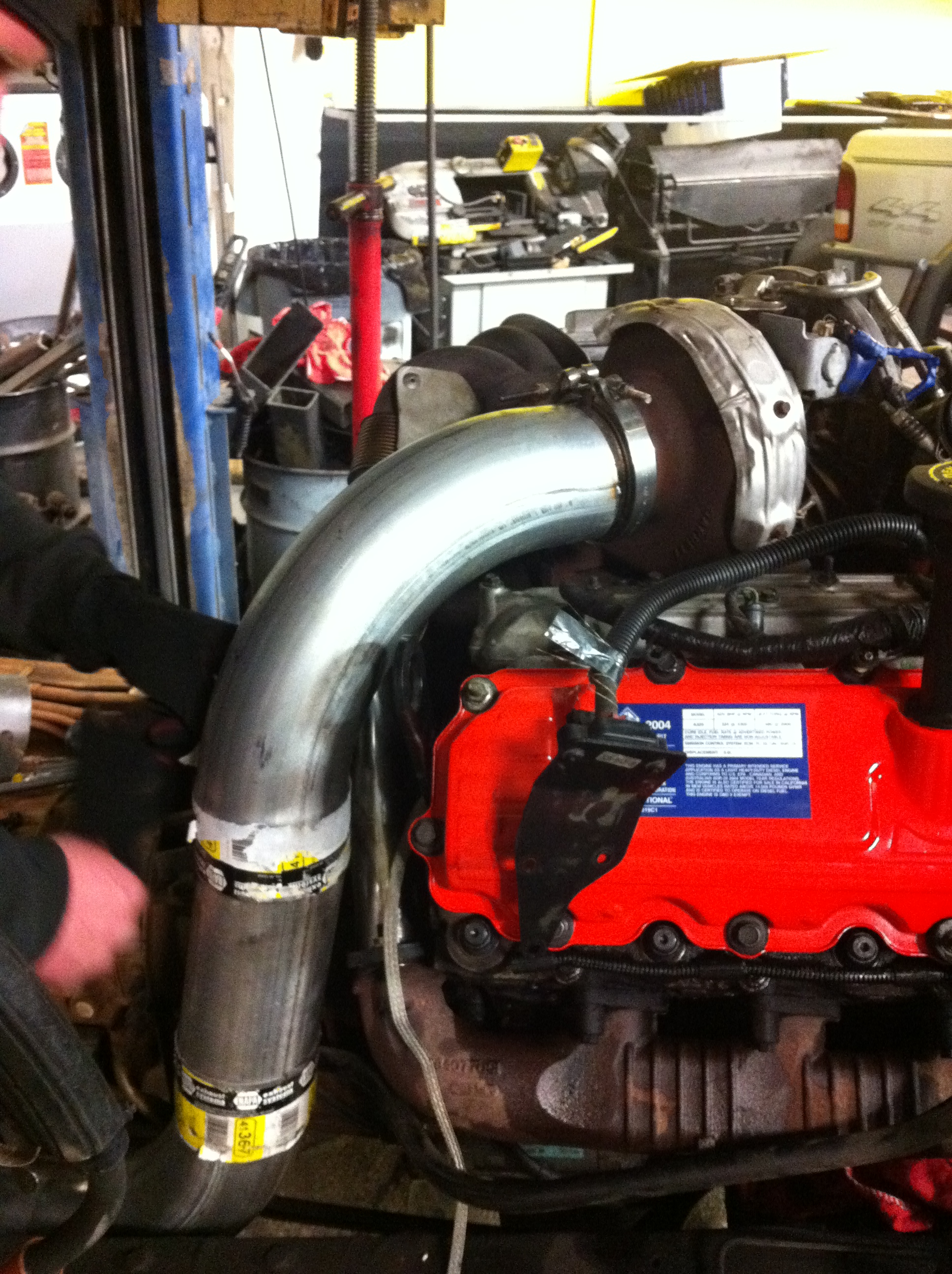

And one with the head mostly back together :hammer:

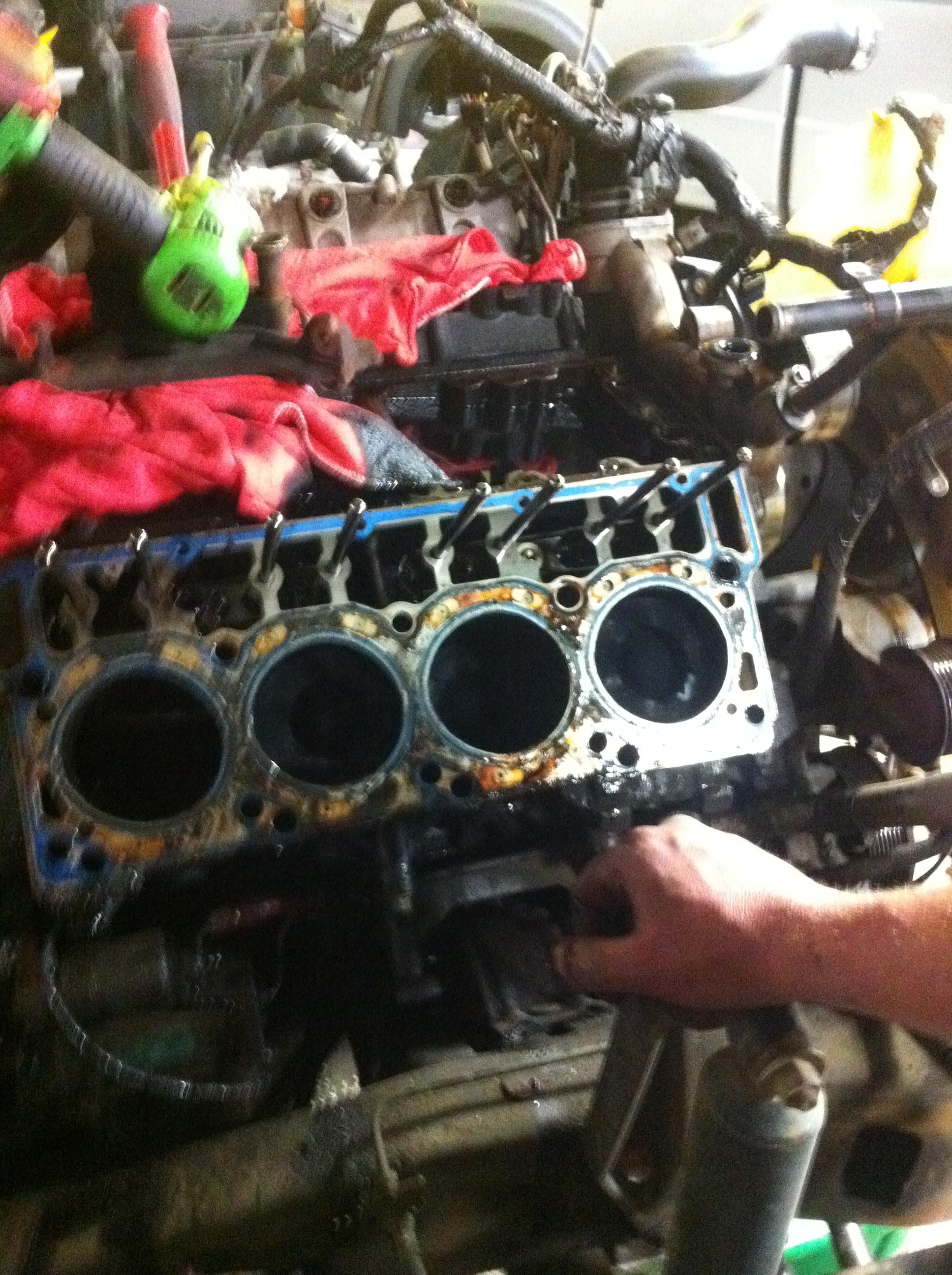

man You really really should have used stockers gaskets. I can show you pics of a failed black onx gaskets that my buddies doing work on right now. It was done by the previous owner and was studded and it still blew them. The heads had been milled as well before to make them flat and it had .30 over pistons so I'm assuming the truck got a full rebuild sometime in the past. Its an 04. Once it was torn apart it was also discovered that the pistons had made contact with the glow plugs as well as valve to piston contact. The truck did not have a tuner either. I really really wouldn't run those gaskets since they failed on a non tuned truck that had the heads done also for flatness. Failed black onx gasket
