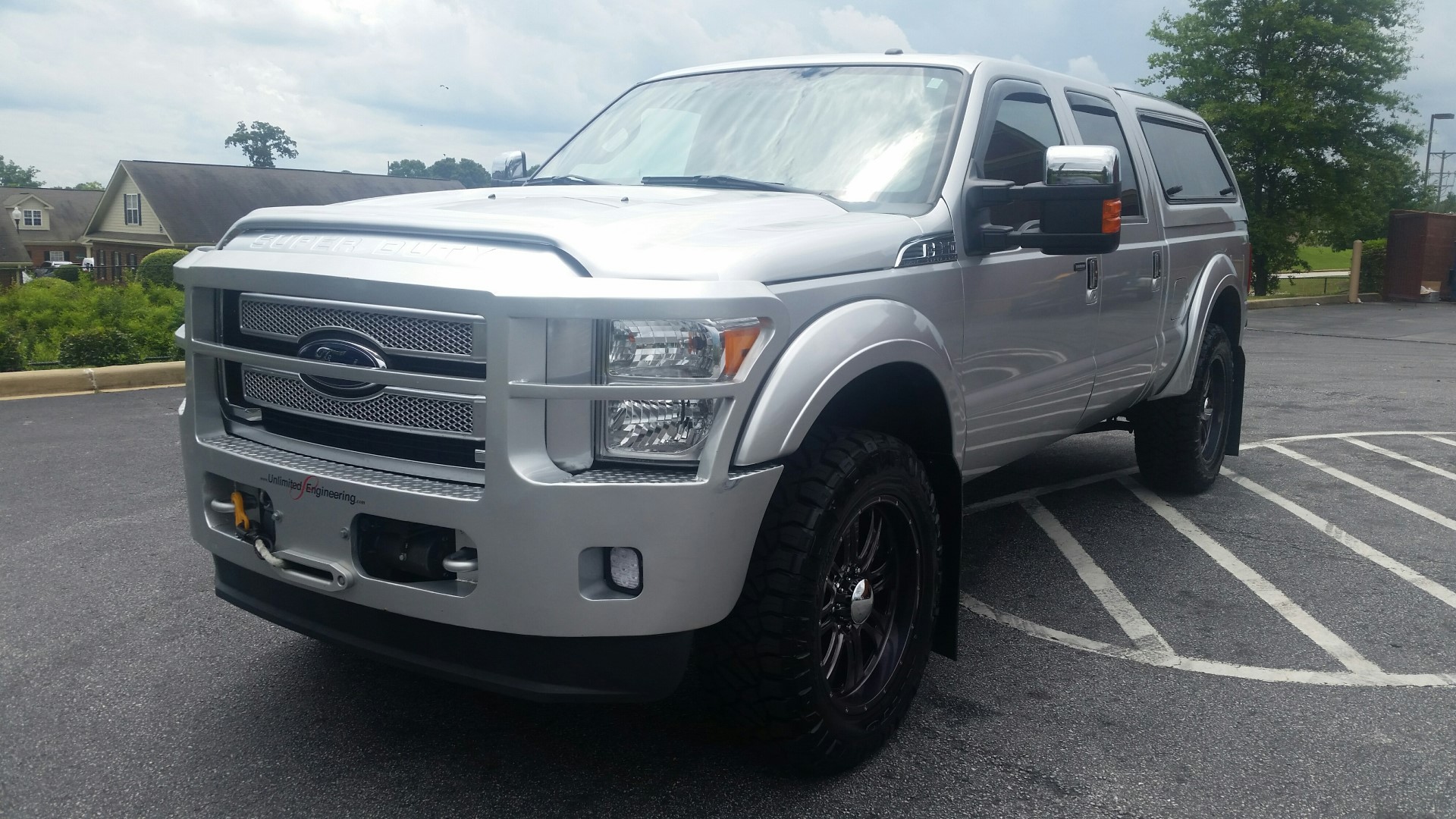

37" ridge grappler on 22" wheels w/ a +10 offset.
I would definitely like to get the PMF blocks that center up the rear and their 3 link and move that front axle a smidge forward too.
Tuner and diet first though. Getting really tired of 11mpg.
