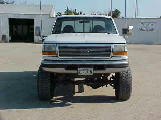

I'd recommend a carriage works grill though. Hands down the best looking billet grill for the OBS. It maintains the outer grille shell surround. So it matches the headlights.
My opinion only but that subtle change will complete your front end perfectly!
This is the grill I speak of...
