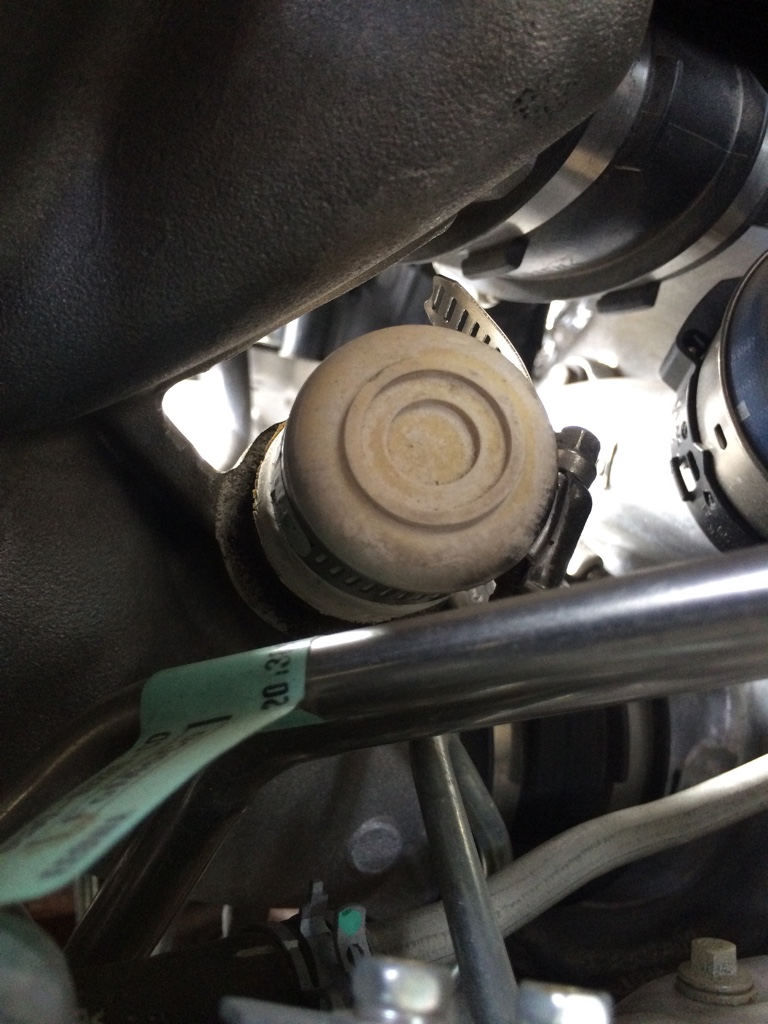

I'm just gonna say I went the cheep route until I do the turbo upgrade then I'll ****** the ccv factory box. I grab one inch hose and a clamp, been running it for over a year without any issues. I think I have 7 dollars wrapped up in it. I guess if I'm doing something wrong someone please fill me in.
Serves same purpose . U plug the hole in the intake ?
Yes I plugged with a bar stool rubber foot and a hose clamp, I haven't had any dust or anything enter the the intake.

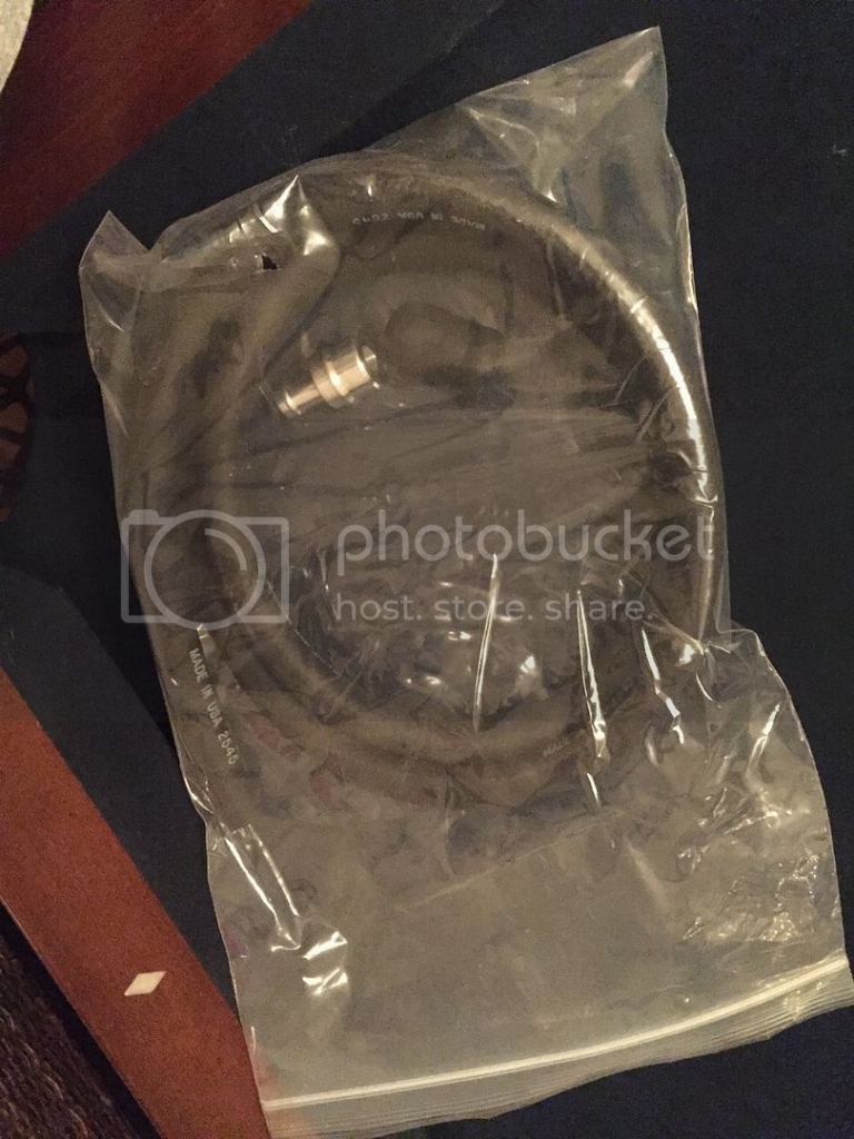

I have the kit that leaves CCV in place make me an offer. I have a full ****** it came with the H and S turbo kit. All is new except the nipple deal. That is about 1000 miles old.

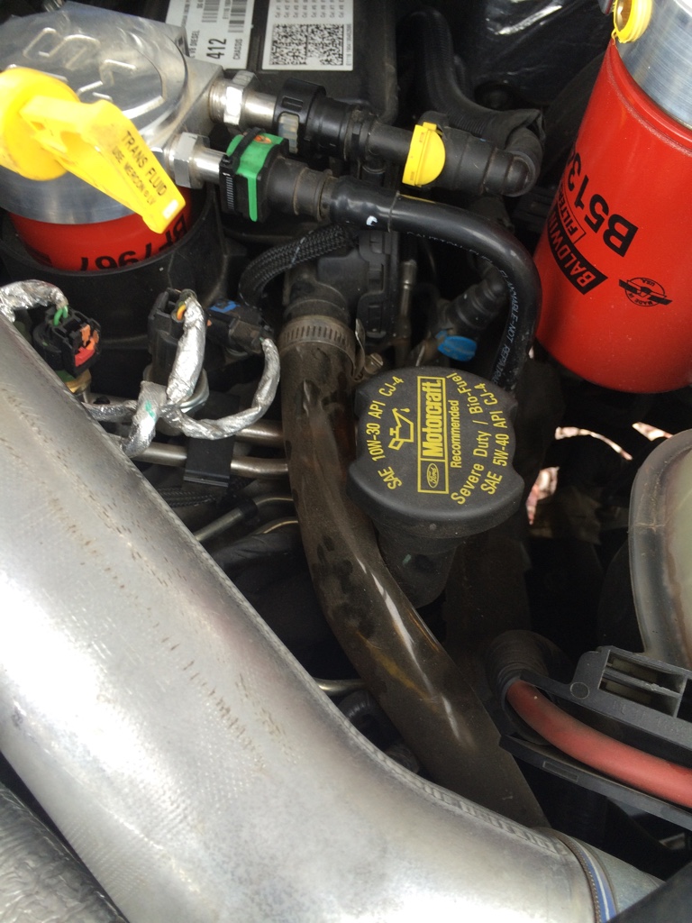

For those of you asking about the factory CCV box, it does have a filter in the box that traps a large amount of oil and drains it back to the engine.
If that is the case why does it drain back into the intake too?
Intake creates a vacuum and pulls some oil back through
So the box pulls from the crankcase then drains back into the engine AND the intake?
Edit: Googled a picture. I see how it is now. I just don't see the rubber plug in the H&S Kit picture that would plug the intake which is what was confusing me.
