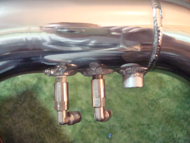

Here is my No Limit pipe with three bungs. I have two water injection nozzles for two of the ports. However i have to grind them down for them to be able to thread further in. If i didn't grind them down the nozzle wouldn't atomize like it should because the spray would've been hitting the sides of the bungs and would've been creating large water droplets. I have a CFM+ carbon fiber large mouth kit for sale if anyone is interested.
