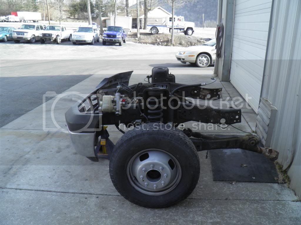

Here's how every 99-07 SD started life. LOL That section of frame is not cut just for more future reference.

That would make a 4x4 swap really easy to just get a frame and separate it there and do the same on the other truck.

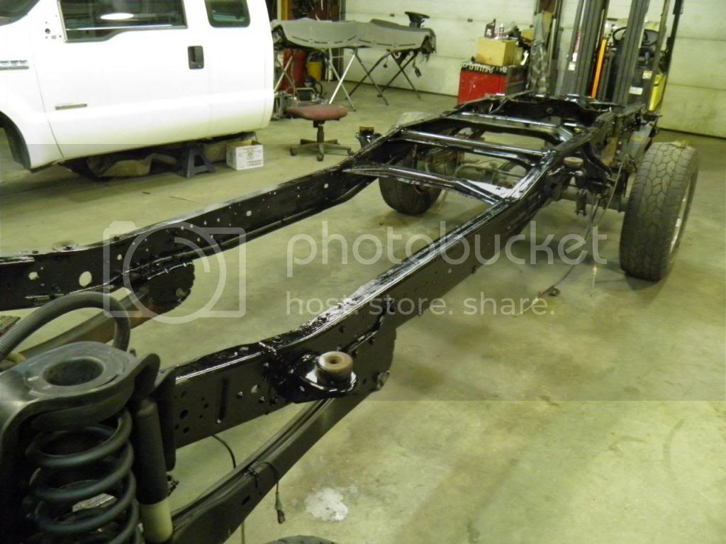

4wd and 2wd frames are all the same. So that's all a bolt in job without having to split the frame. That changed the frames some in 08 but still bolt in for that swap. We converted a 12' last week to 4wd.
On that build we converted a 06 Ex-cab C&C truck to a ec/sb. Also converted it from a 6.0to a 7.3 and a auto to a manual. :ford:
Here is that frame back together and you can see the cab in the back half of the pic. We left the original 06 4.10 front and had a matching 05 4.10 rear from a gas truck.
So that was kind of unique to since you couldn't get 4.10s in a srw diesel truck.

What kind of paint do you use in your frames? Getting ready to blast and paint mine and have always used a satin finish but that gloss is lookin pretty good.
co04cobra
3,003
10
WV
From a company called Kimball Midwest. I want to try POR15, on a whole frame, sometime in the future.

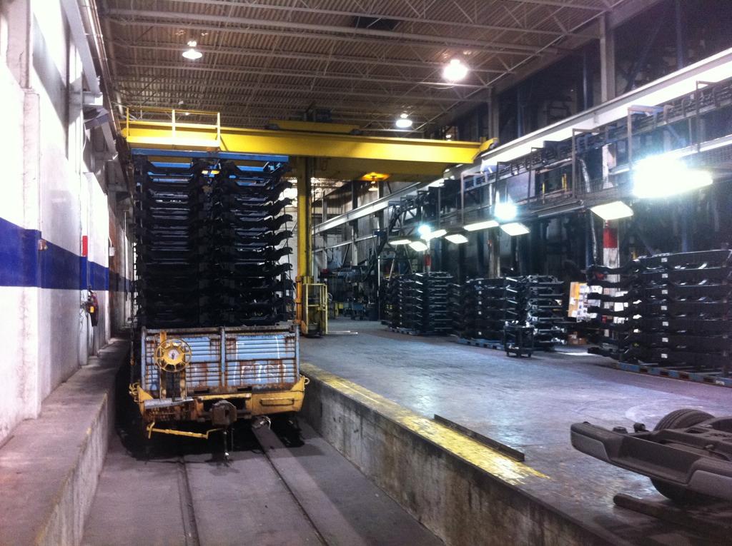

We do work in a structural plant. It's neat watching the process from a roll of coil steel on the back of a semi to fresh dipped frames hitting the tracks. The engine area of the frame is usually similar to one another and they are made as a sub assembly. Then from the splice at about the firewall back the frames differ in lengths. The plant we do work in builds gm cab chassis van frames and extended van frames. They can be pretty short or really long but the front clip is all the same. Also in the plant while building and shipping the frames, the tags are right side up. The factory puts the frames in vehicles upside down. :D
