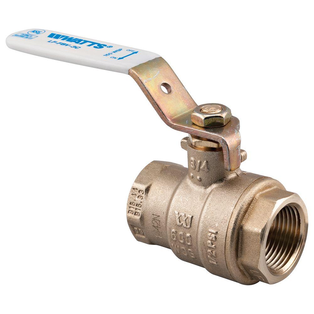

I want to plumb in a fuel shutoff in the supply line from the sump. Will a regular old 1/2" ball valve work fine in a diesel application? Don't really care how it looks as it'll be tucked up against the frame rail. Trying to keep from having to order and wait on yet another part. Been waiting for over two weeks now as it is on 6 little parts, and still don't have them all yet.

I would look for one with the WOG"" rating water oil and gas or maybe order one for diesel from say Duda bio
this is one ( you can see the WOG cast from Homey Depot
if you use say a shark bite push lock I am not sure their o rings can handle diesel ? i would find a compression style ??

Don't see why it wouldnt. It's 1/2" ID hose...not like we are talking about a ton of pressure either. Still might check the local big box stores and see if they have a regular barbed end valve.
