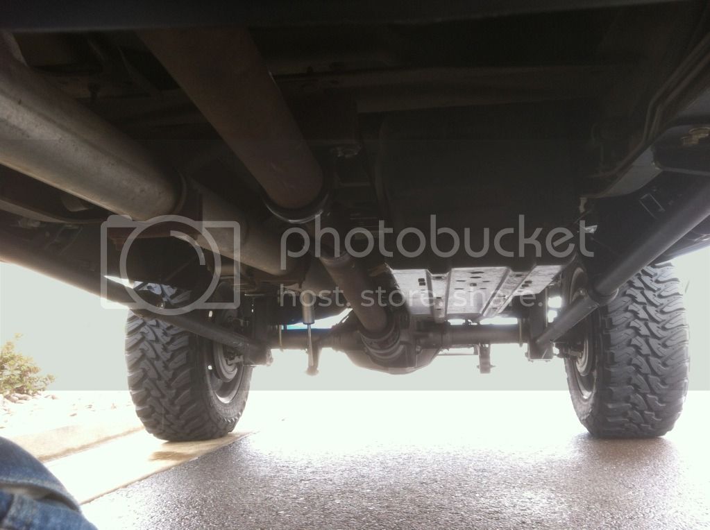

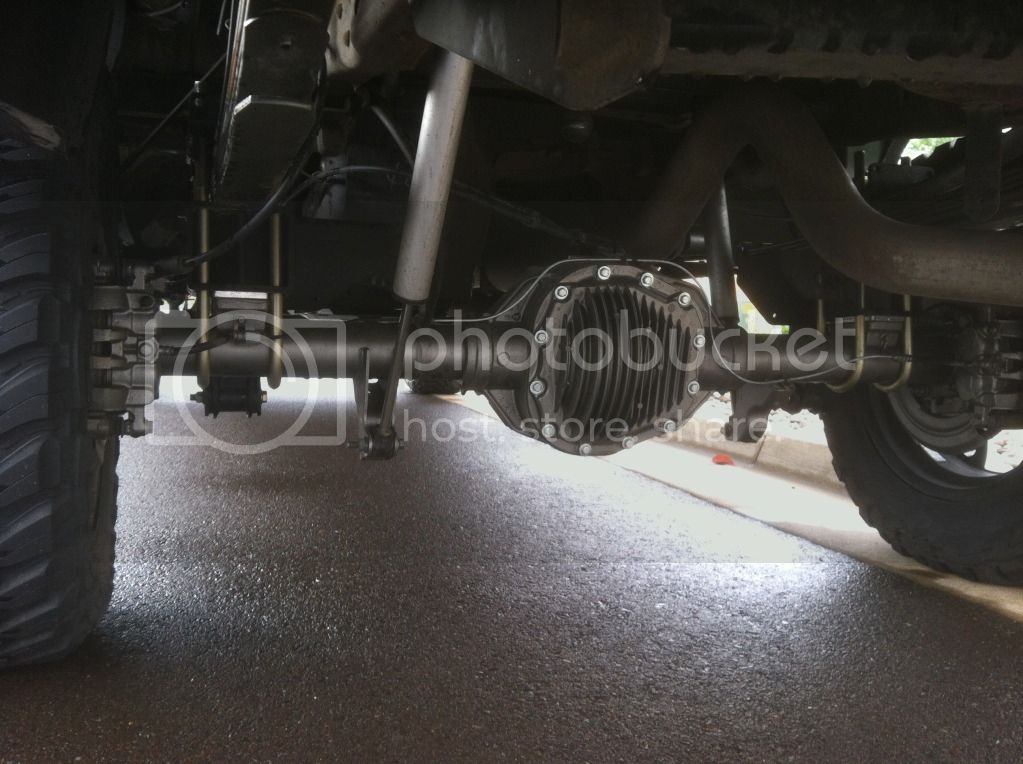

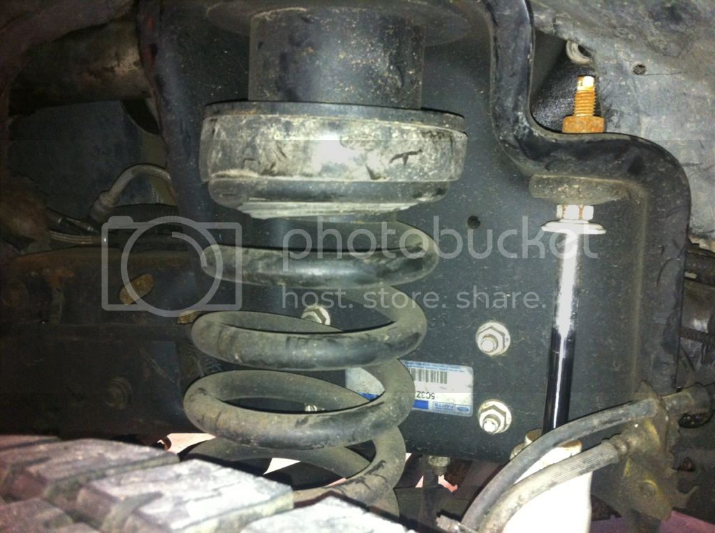

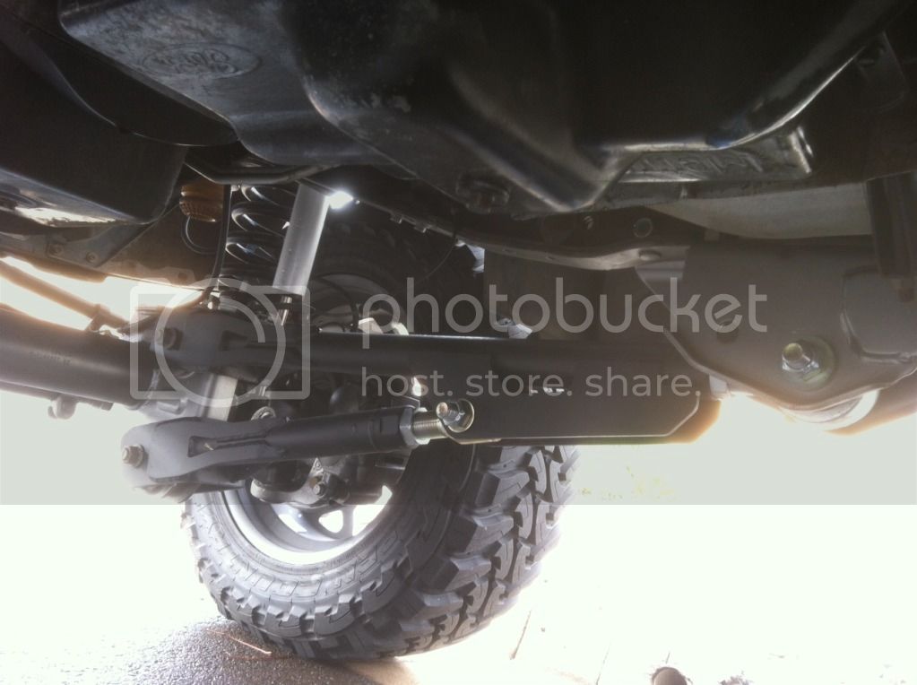

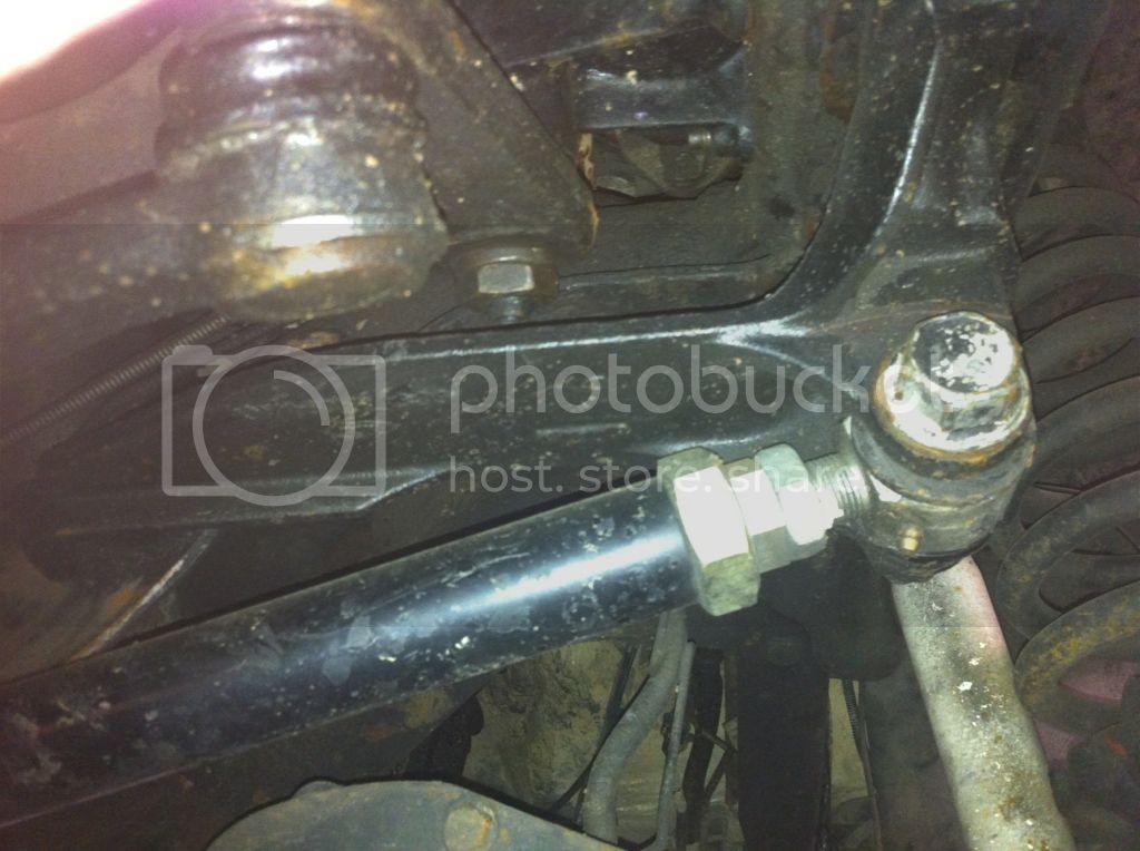

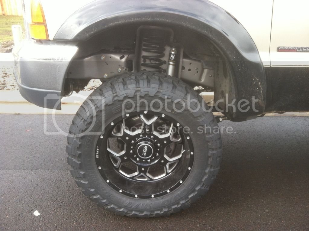

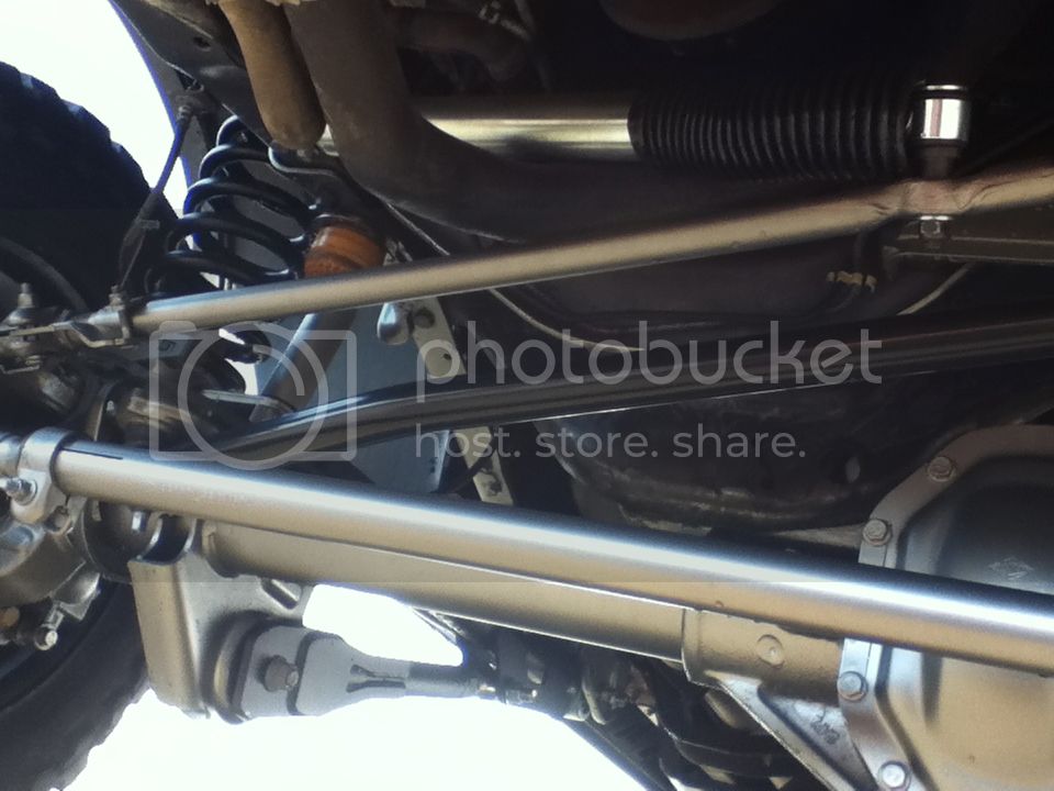

Sidwaz, did you pull those parts from a truck? It will be good to see a rig complete.
Here are some pics.
Layson
1,638
We put a full 08 suspension on my friends 2000 truck. It isn't really hard to do. Only thing we left out was the 08 leafs. I will post some pics here shortly.
Layson
1,638
He has an Icon 4.5" lift with 35's. OUO ALA's, OUO Traction Bars, 05 track rod bracket, 08 steering box.
