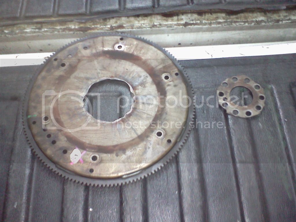

Had to drive it today, no other choice. Still driving just fine, and doesn't seem to be getting any louder, or quieter for that matter. I did notice the ring-gear isn't on the flexplate evenly, but none of the welds are cracked/broke, and the flexplate/converter doesn't appear to be wobbling or anything, just something odd.

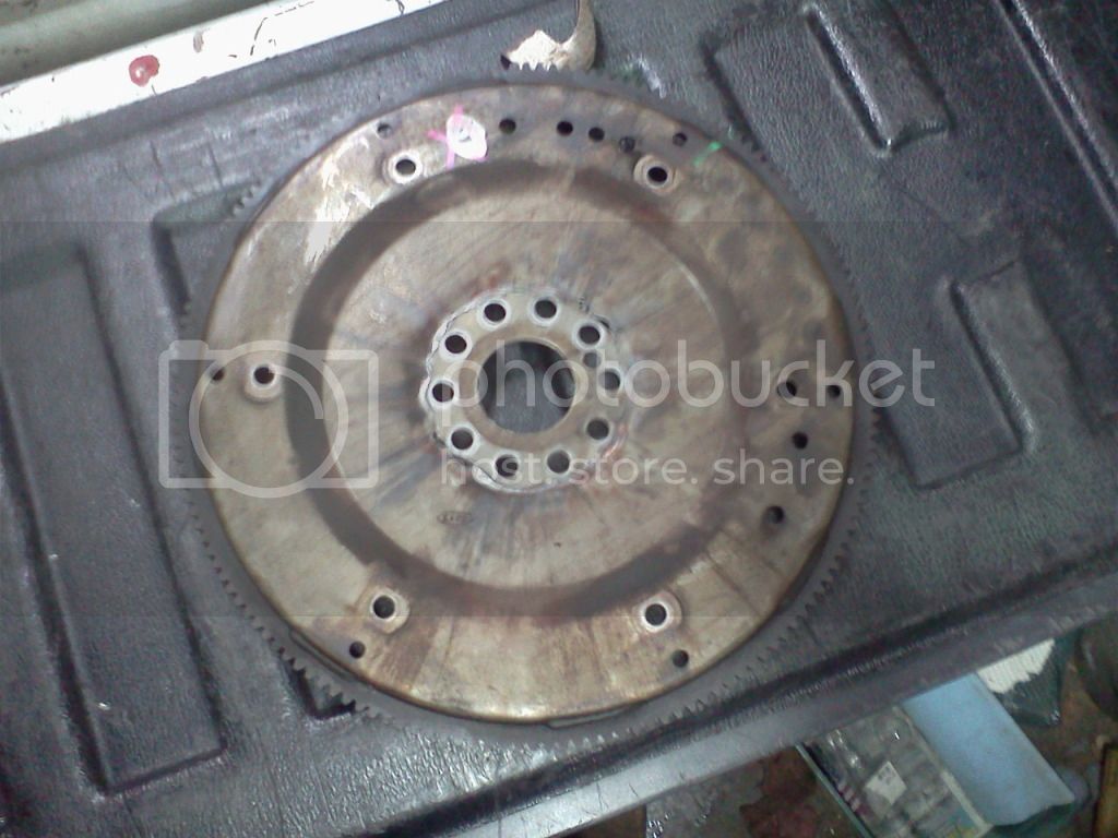

Completely busted, I'm amazed it pulled itself up on the gooseneck....
One slight tap of the hammer later....
JD3020
4,002
Farmersville/Dayton, Oh
Ouch!
I'm amazed at the number of 7.3 flexplates that fail, and they all fail in the exact same place, the exact same way. Yet so many of them are still able to move under there own power somehow. LOL

I could hear it much better in the second video. Its that trashy sound when it idles up correct? That is a weird noise. I guess it could be a flex plate but sort of seems more like the sound that could come from the converter. The flex plate I have heard that look like the ones in the pic really mess with the idle. Its not that sound but who knows. I have been very lucky and never had one break on a truck I owned. I think a few of the farm trucks that pulled round bails had though. Never was there to mess with them though.
