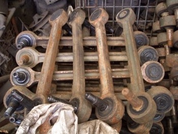

Great idea, btw! I did something similar to break torque rods loose on 5 ton trucks in Kosovo. Placed bg azz pipe wrench on threaded end and then used a porta-power (combined with the weight of the truck) to break the tapered end loose. Worked like a charm.

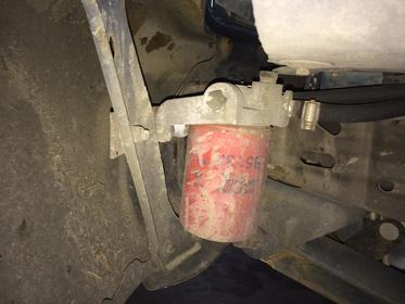

Here's a pic of my mounting. Makes for easy change. Have valves to ease the mess.

Valles are good. Couple of 3/8" npt ball valves eliminate any mess. I've got mine mounted from the radiator support, on the drivers side, and zero mess when I change the filter.
I pull the inlet from the water pump, and the return ties into the degas bottle line that runs across the top of the header,. I used a pex tee, 3/4" if i remember correctly, and worm drive clamps, no leaks.
