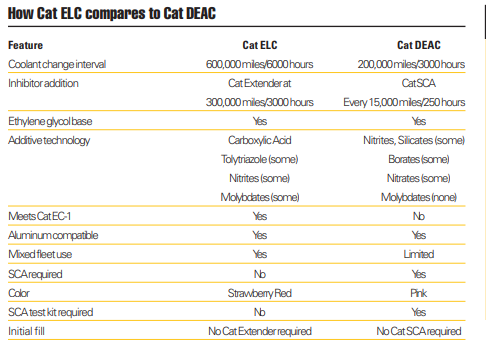

I drain my crap out and I run Cat elc in everything I own. Never a problem. If it’s good enough for cats million dollar diesel machines then it’s good enough for all my diesel trucks

Yea I’ll have to find the link where I read the cat elc is compatiable with aluminum, cast iron etc but I do know it said it exceeds requirements for Cummins, paccarr, Detroit as well.
Both CAT ELC and ELI (same additive pack - glycol free) are NOAT coolants and compatible with aluminum.
No issues mixing NOAT & OAT coolants, you just diminish the additional cavitation protection nitrites provide.
I've always abided by the rule that you can use a NOAT/OAT coolant in place of a HOAT/IAT, but not the other way around.
Definitely do not mix NOAT / OAT coolants with HOAT or IAT as this is when you will run into issues with silicates coming out of suspension and sludge forming.
