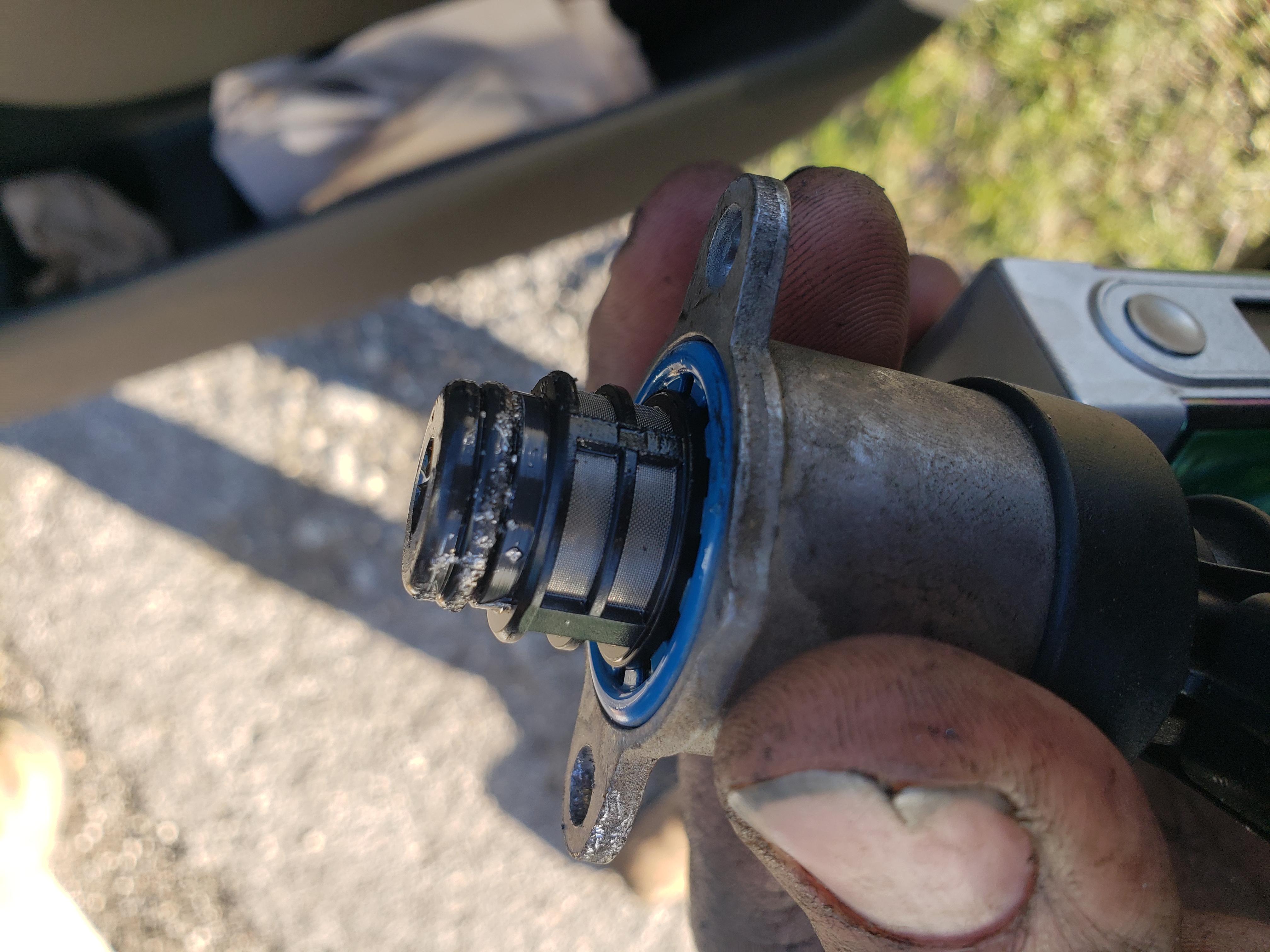

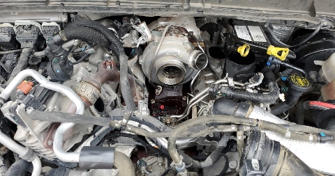

From a beloved cp4 today on a Duramelt with 175k. Guy said he got a fuel filter warning, then it just shut down on him. He said he drained some water out of the filter afterwards, and then replaced the filter. Lol.
Oh man I love seeing that. Money in the bank!
