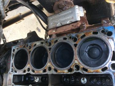

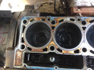

I have a couple pics I took Sunday

I'm just wondering if the K16 was leaking into the crankcase and then it melted a hole in a piston and created the pan removal scenario. No idea, honestly. Just thinking out of the box.

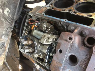

I've never really messed with the fuel system on these trucks where should I start digging in to it?

Sorry I meant the pump itself what should I be looking for, should I pull the covers and start looking at the internals?

You wanna look for metal in the system which will be difficult now that the injector lines are off...you could look in the supply ports on top of the pump with a flashlight and if you see a lot of "glitter" that's metal...which means the pump is goin bad

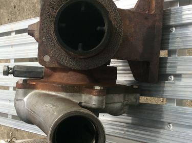

Got it pulled today and got the pan off f it, it was a pia getting that mangled pan out of there! Lots of metal shavings floating around in the pan. The dent in the bottom f the pan is from me jacking it back up with a floor jack to get it off the cross member.
