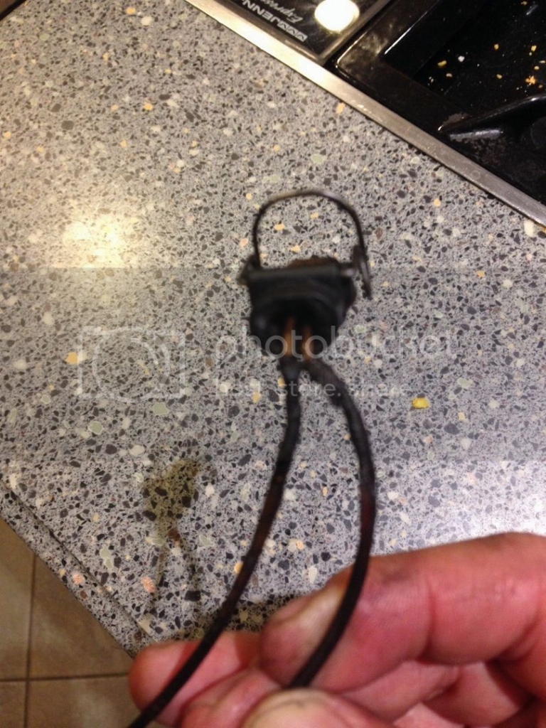

How does the IPR harness look? This was mine when I had a no-start issue.
Rusty
