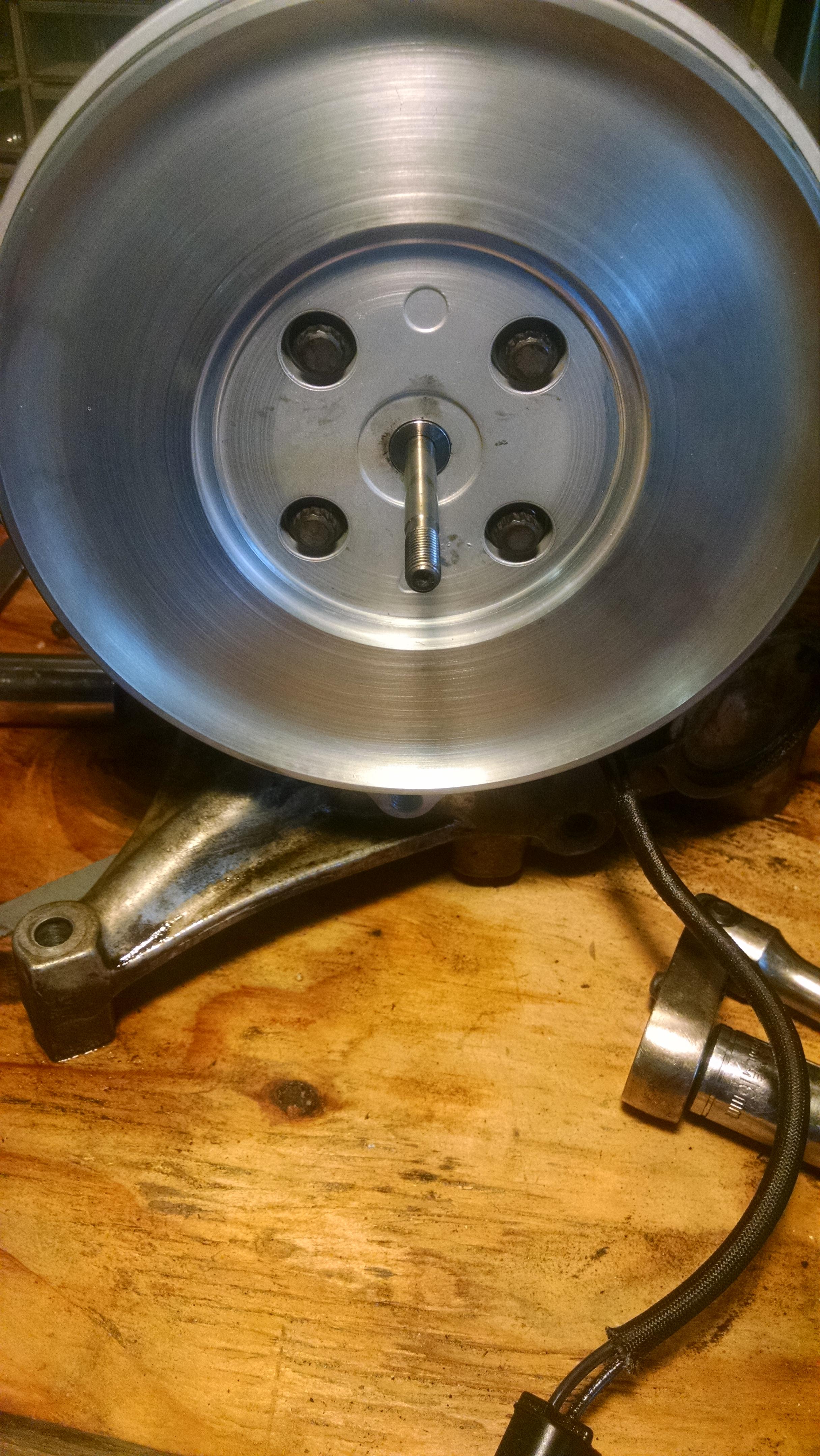

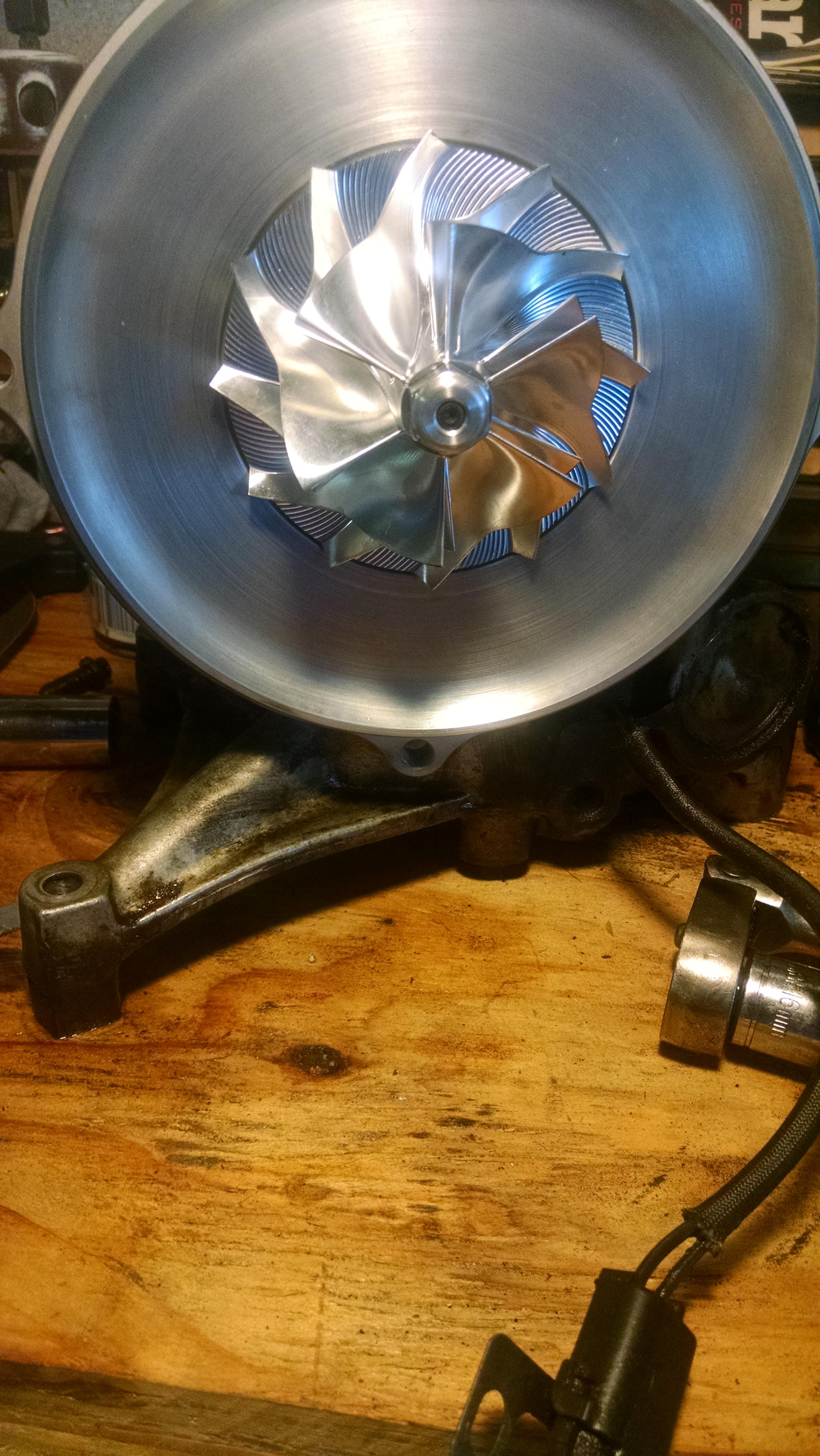

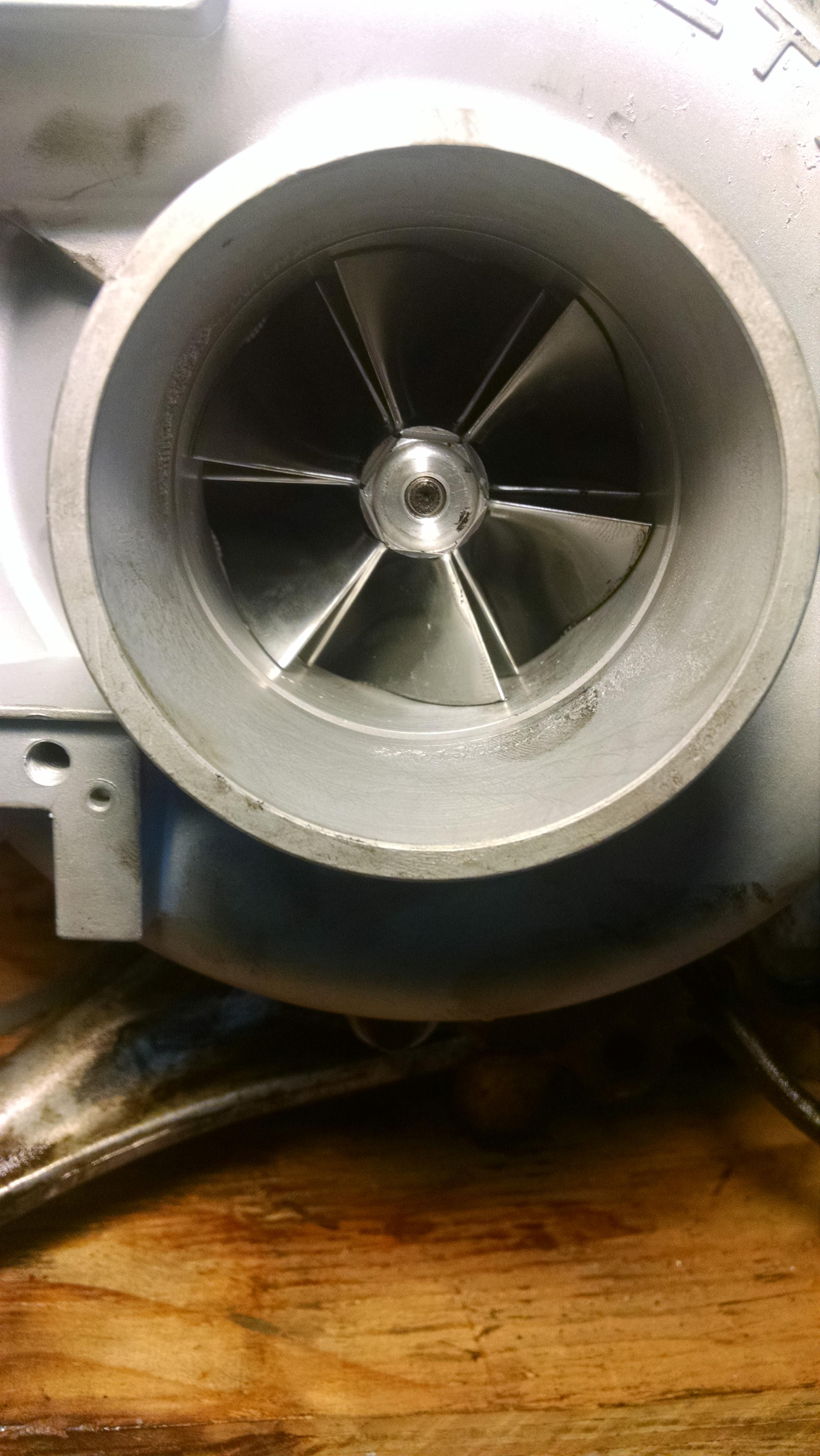

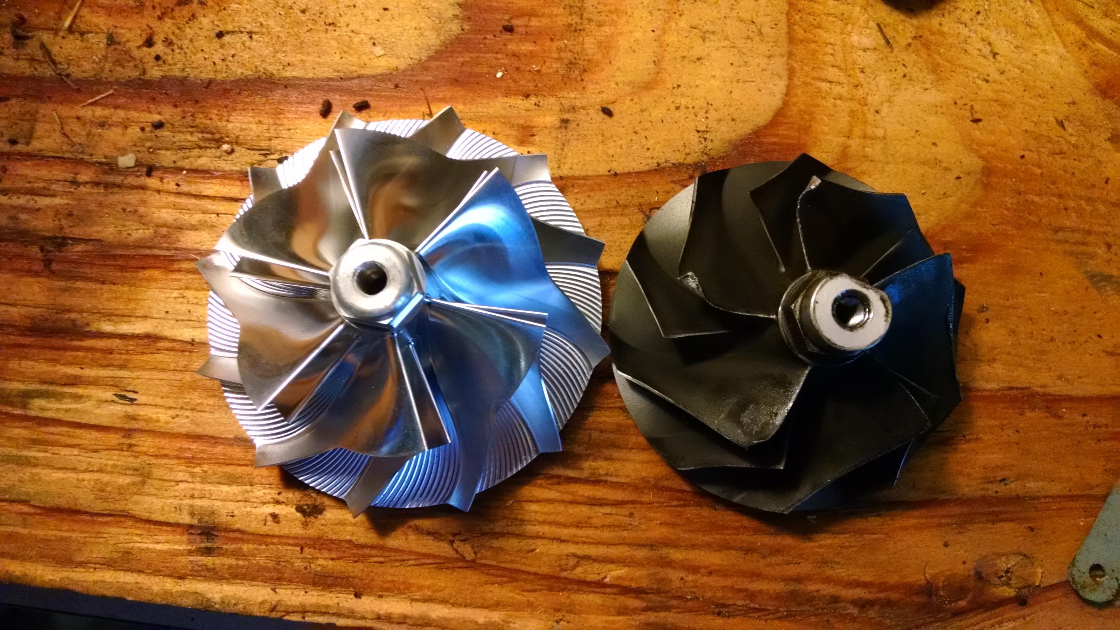

I would recommend either turbo builder they know there chit. James also offers a diy 66mm turbo and for guys who want a upgraded turbo he offers a 63/92 wheel that's the 63 wheel I did in my neighbors truxk
