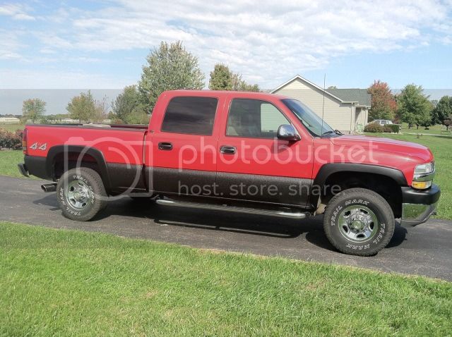

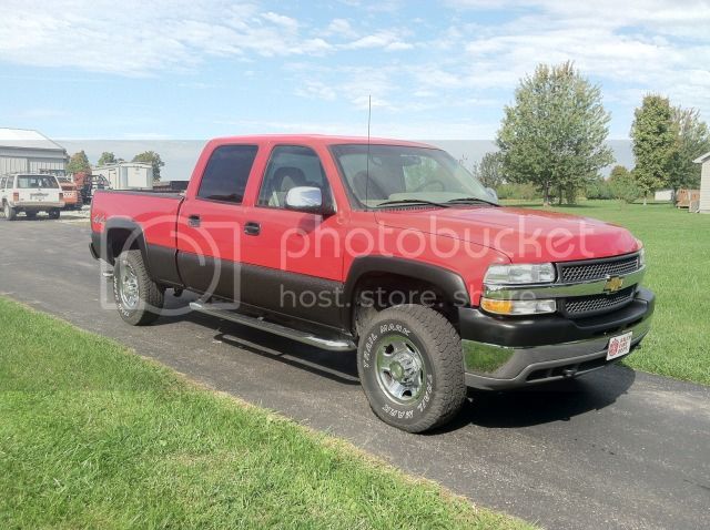

I actually sold this truck the first part of September. I picked up a low mileage '01 Chevy Duramax CCSB LT for a steal. I must say, the Duramax has a ton more power than the '97 had and as far as creature comforts go is a LOT better.
Here is a couple pictures.

Love it. Best truck I've ever owned, especially now after I had it EFI Live tuned. It is putting 443 HP and 842 lb/ft to the ground. It is a beast. Even in the lowest tune (317 HP / 644 lb/ft to the ground) I can't keep traction.
