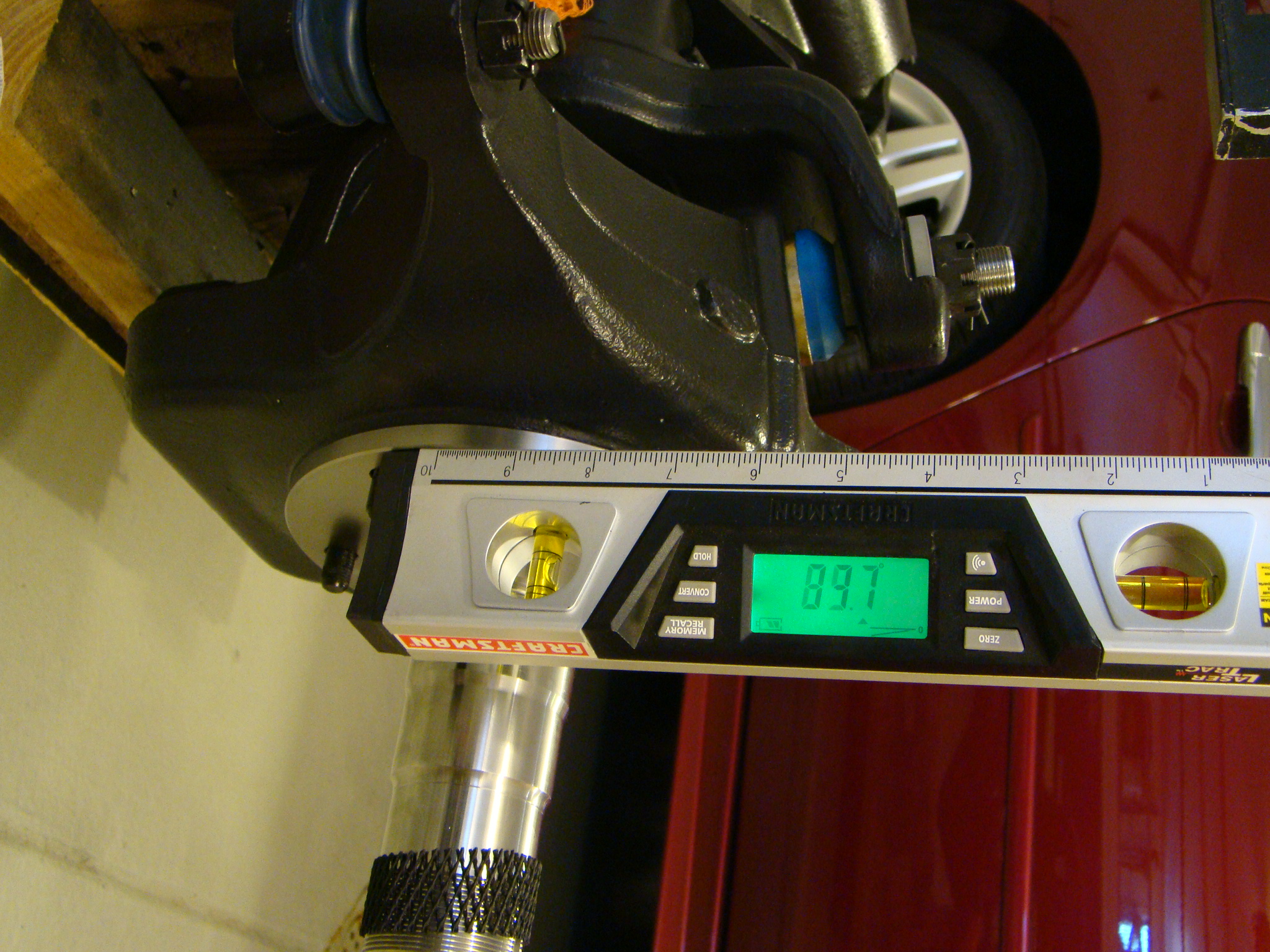

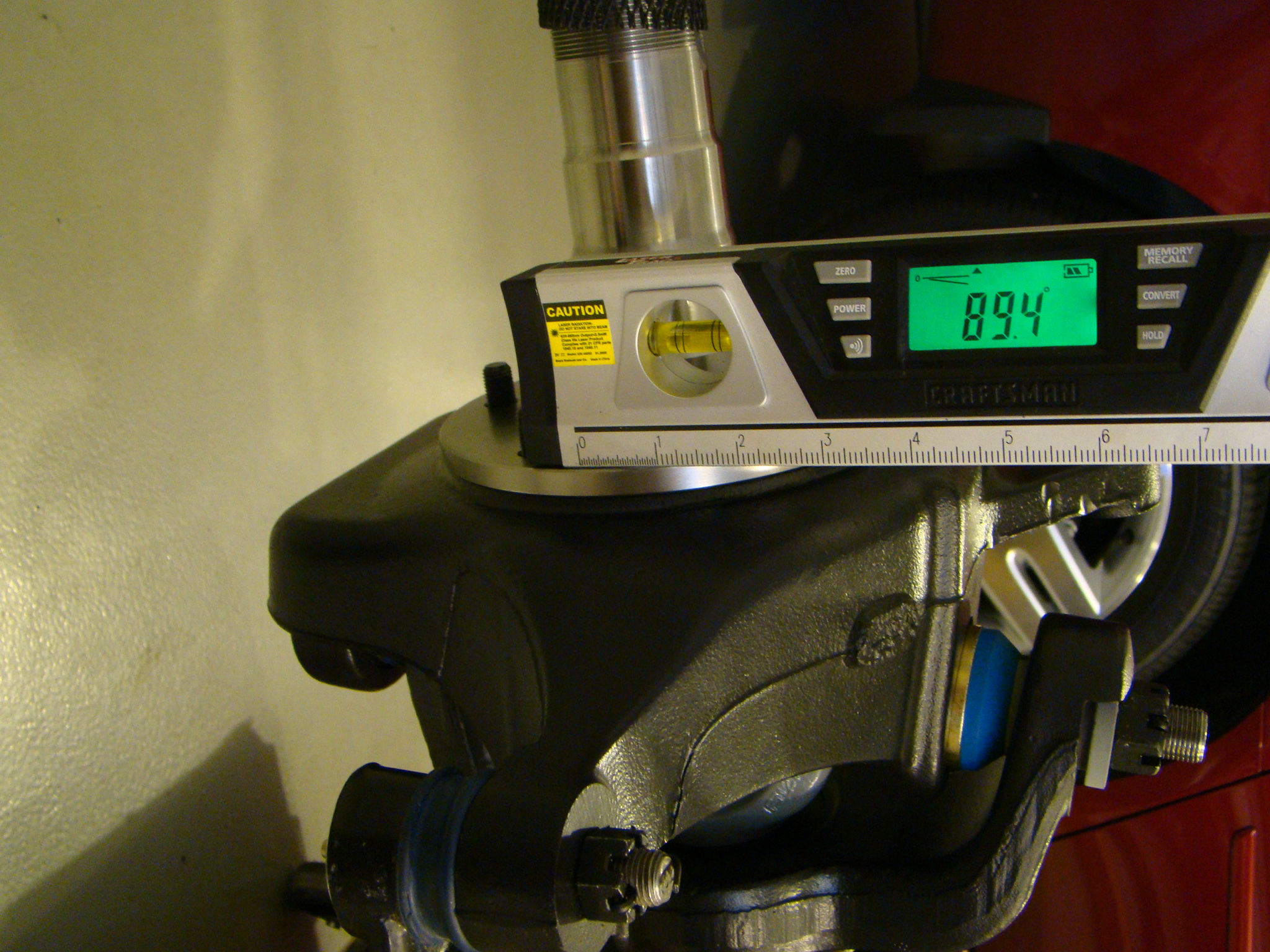

I also wanted to check out how true the axles was for an idea on how the alignment might work out. I leveled the axle and then used a digital level to measure the camber left and right.
The right side had .3 deg positive camber
The left side had .6 deg positive camber
I am thinking once the axle has a load on that those numbers are going to be pretty good. The camber specs are 0 deg +- .5 deg.
