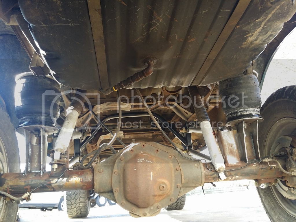

I would suggest a duramax aam 1150 rear end over a dana 80 any day
This is a terrible idea Chevy uses the thinnest tube of everyone's axle.They are best in the scrap pile
Dana 80 in a dodge is not really a true 80 its considered a 70/80 hybrid
the dana 80 used in early 94-94 superduty was a true 80 bigger axles and so on in the late model super duties.
I have a 01 dodge dana 80 in my 99 fummins conversion the perches will need to be moved,shock brackets as well the speedometer will plug right up and work
In my 95 fummins I have a dodge 11.5 AAM but mine is full air ride on the rear
both rear axles are wider than the stock sterling axles
