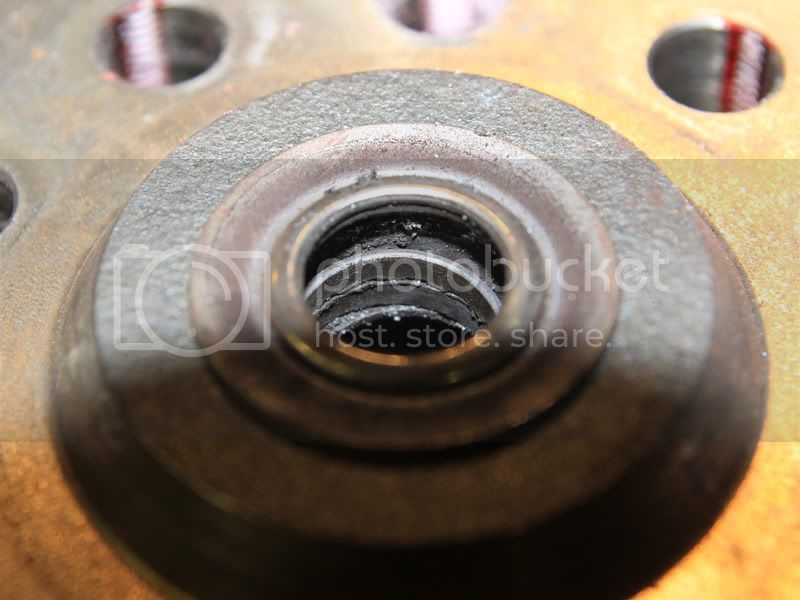

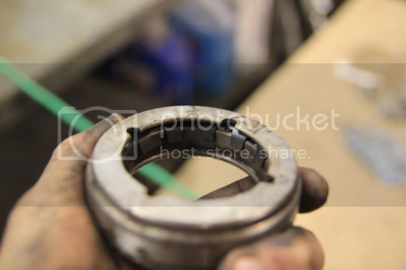

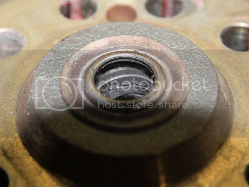

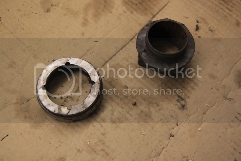

Well just a little update. Finally got South Bends FDD32506 installed. My pilot bearing went out on my Valair clutch(forsale with 15k on it, good condition). Very happy. Quiet and pedal is way softer. I would say about 1/2 the input is needed compared to the Valair. I have never ran stock so I cant compare it to that. I probably would have went with Valair if it wasn't for the deal I got with my South Bend. I am going to break it in for 500 miles and then see what it can hold. Couple things I did notice is this clutch is way heavier. It was a beotch for one man. Starter seems to turn over slower now. I should of taken a picture but the pilot bearing is more way beefier then stock. Overall impressed.

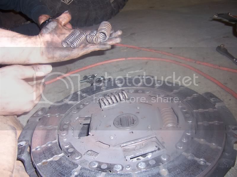

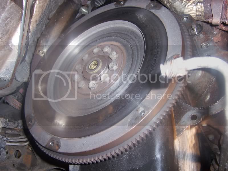

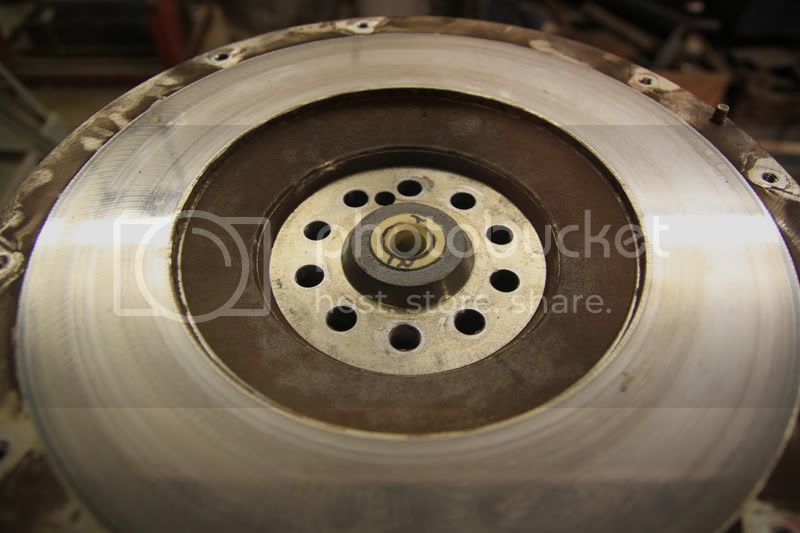

Pics of the southbend I pulled out of my 7.3. I bought the truck with this clutch in it. So it may have been installed wrong. I dont know. I know many people swear by SB. They are well known. I just had bad luck I guess. Although, from the previous posts, I am not the only one that has had this issue. This also happened in my Duramax.
The springs ground my flywheel
Valair Ceramic 650 SD :) The pedal was stiff and it grabbed quick. That is what I wanted.
