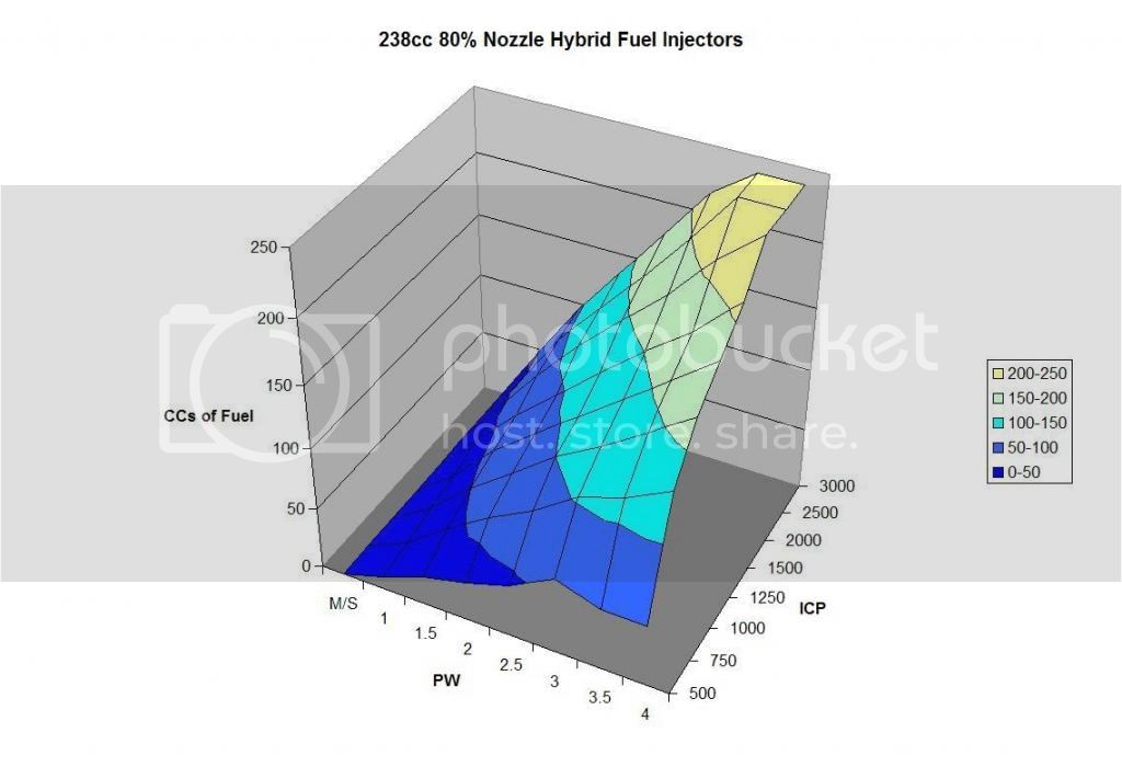

Here is a 238cc hybrid with 80% tips:
Not much to talk about without something to compare it to - so we will just call this injector a 238cc "FAST" Injector with undisclosed tips (mostly because I don't recall the specifics of the test off my head and all I have at the moment are graphs, but lets just call then stupid big and exaggerated for effect in this discussion)
These two graphs show the exact issue that Jay has with larger tips - they are a pain in the ass to control lower ICP and shorter PW occur. They aren't EASILY friendly to drive day in day out or tow because of this. I totally agree no problem.
Now comes the magic. Here is the actual flow rate data for a 238cc injector with the same tip as the stupid one above.... but pay attention to the ramping on the graph.
Its ALMOST as controllable as the 80% tip down low at the minor sacrifice of softening some flow rate at the high end with plenty more area to inject 238cc in a shorter window than the 80% tip. Now - granted a lot of what was done internally on the injector to produce this graph hasn't ever went into production injectors for customers (that I am aware of), but it goes to show you that you can have identical volumes, tips, and injection ratios and still have a wide variety of flow characteristics based on what is done internally - THIS is the issue with trying to tune the "same" injector but built by a different manufacturer and is the crux of the issue with producing tunes that operate the same from truck to truck with the "same" injectors but built by different people.
In conclusion - I totally understand why tuners recommend small nozzles - they are easier and far less variability from injector shop to injector shop. Its basically the only way to guarantee the customer has a good experience without putting together a complete known package for them. I disagree that a 200% can't be a towing nozzle in the right package - the issue however is for the layman (and even the experienced tuner) to know how each shop builds their injectors and modifies them to either increase/decrease control resolution.
