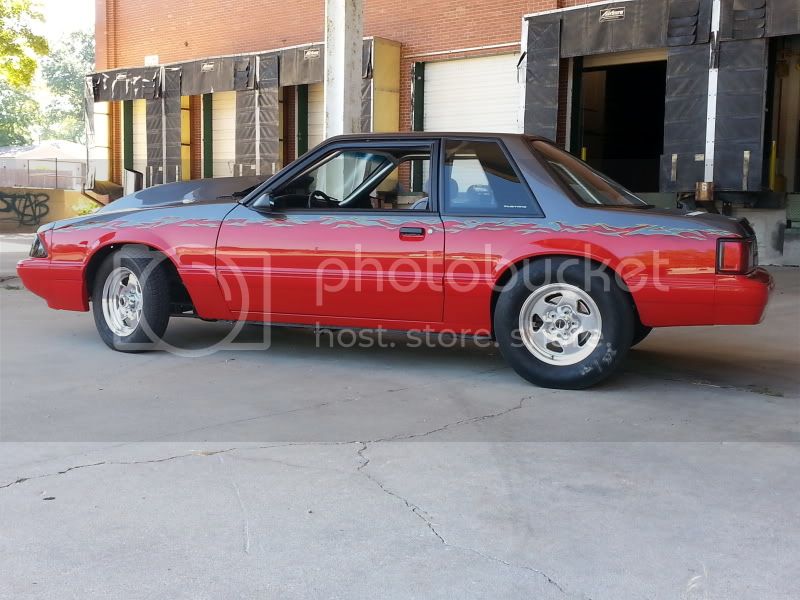

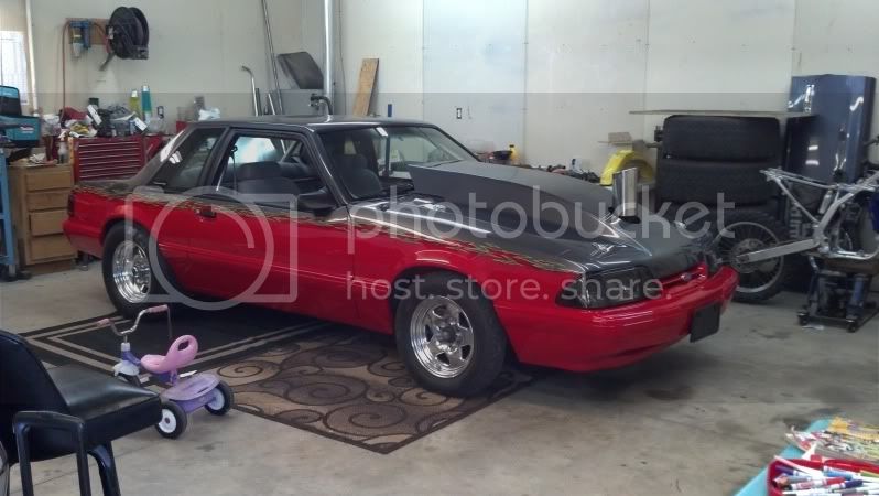

I like everything except the hood stack. I think I'd do a fender exit.
mandkole
Jan 14, 2012
2,303
Northwest
^^^WHS Im a mustang guy and I love it, but the exhaust had the easy button pushed. Im feeling pro 5.0-style side fender exit... It would need to be behind the tire to not let smoke block the beams at the track.
taterthedog
Jul 3, 2011
1,963
Canada
I like the hood stack. I'd say space for anything different would be pretty tight on a mustang.

Damn man this thing is bad ass, I love fox boddies. I have always wanted to do a 6.4 in one for a drag truck
Looks like it gets down pretty good keep it up!!!
Sully
Feb 10, 2012
76
I had plans to do rear exit factory style tail pipes, actually have them and may still but I wanted it to make a statement. there's no way I'm cutting a hole in the fender.I can fix the hood and repaint it in no time being fiberglass and only one color.start to finish in the booth,the paint took 22 hours.with 100 hours in body work before that easily.I will say one thing, when you spend 3 years building a car like this, you might push the easy button a time or 2.

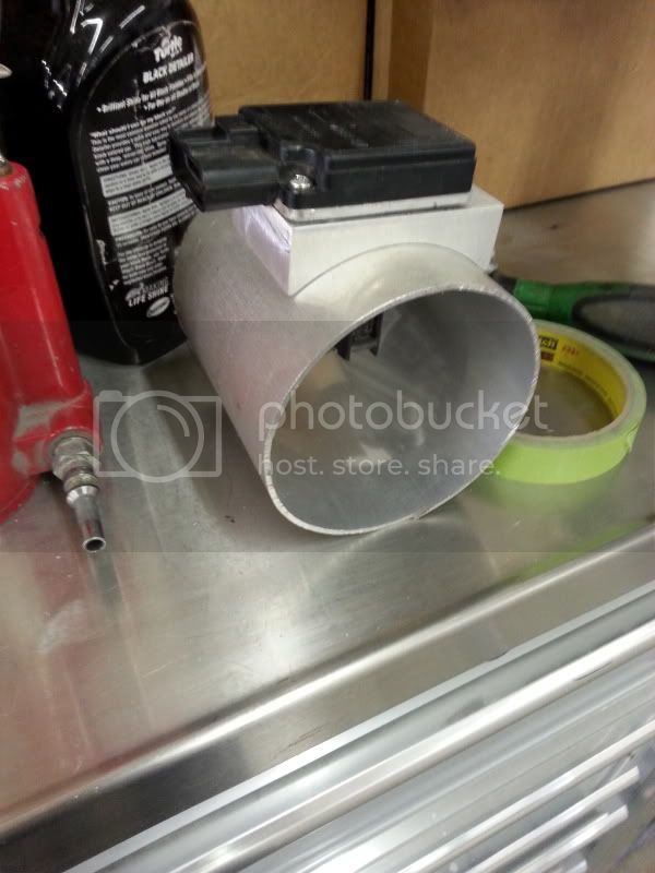

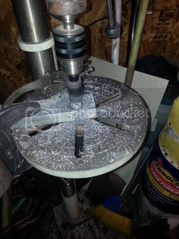

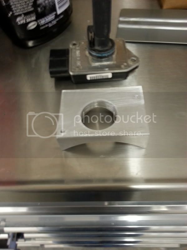

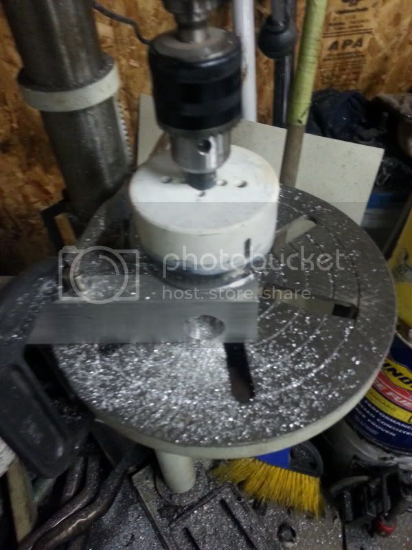

We determined the lack of a maf sensor was causing the pcm to go into emission safe mode and cut fuel.not wanting to pay an exorbitant price for the bung to mount one in 4 inch tube I made one..Just gotta weld it up tonight.hope this fixes the issue.
TheReelMuhcoy
Jul 24, 2012
567
New Jersey
That is awesome! You'rs looks like mine too! only a lot cleaner!, I notched the pipe, and set a piece of 3/8" flat stock in.
Great work man! :thumbup:
