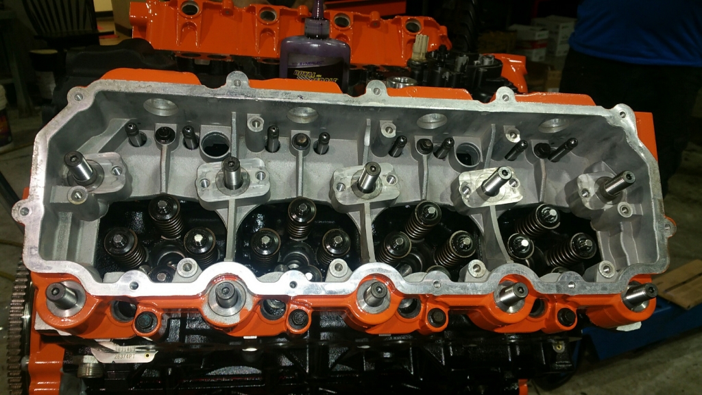

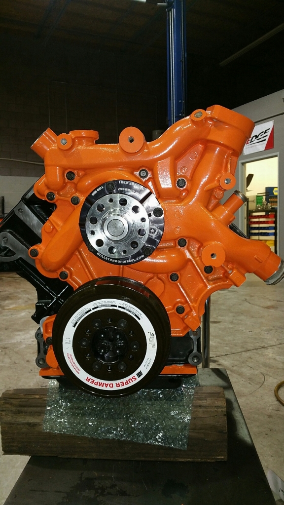

Ok it's time for a update. Finally got my main engine parts from powder coat. Got the long block assembled.
We installed a ATS billet flex plate w/ arp bolts, ATI dampener w/arp bolts, bullet proof water pump, warren billet lpop, honey badger hpop, ARP 625 head studs, new oem oil cooler.
I'm waiting on my warren injectors, warren twin pump kit, the rest of my trans parts.
Trying to have it ready for April 30 NHRDA event here. Fingers crossed :ford:
