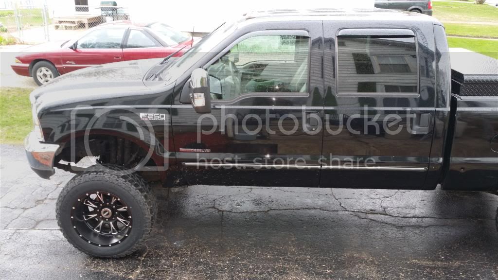

Oh and as it sits with 20x12 and 35x12.5 atzs...

Yep that has a different look than on the 37s. I have 20s with 40s ready to go on sitting in the shop. I prefer the 20s but as I at most will be doing very light towing the 40s with 4.56 is not going to be an issue compared to what guys with real trucks do. My feelings are the same as you. I really did not like the 2 long skinny bolts holding 30lb of HPOP 2' long. I know plenty of guys have run them for years without issue but tons had to deal with inserts to fix the stripped alum threading. My X goes on national forest roads and old loggin roads etc for SAR work and the bouncing etc so I have the same issues of concern that a street rig would not.
